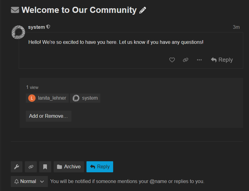

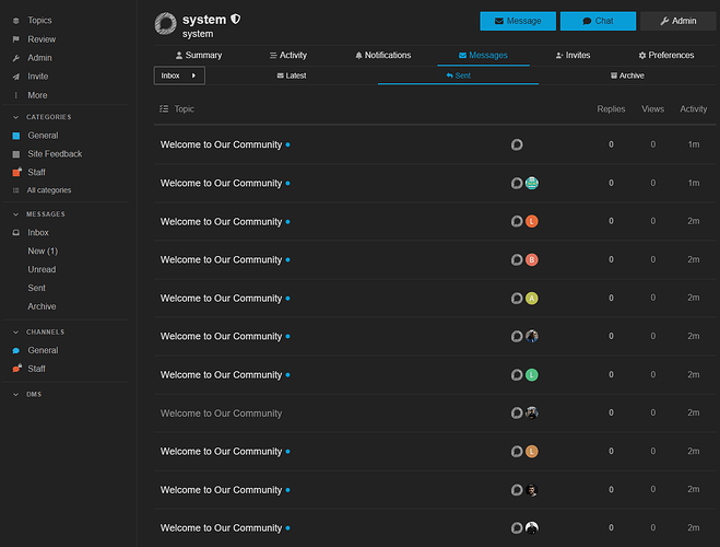

I didn’t do any modification, and the user system sent the MP to all my users in my test instance:
How many users do you have?
