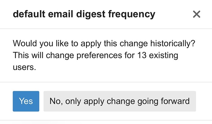

When changing a default you can choose whether to apply it only going forward or to also update any existing ones:
If that preference admin setting was added then it should be possible to update all existing users too. :+1: (though for closed actions rather than the full suite of pinned, unlisted, split, etc)
