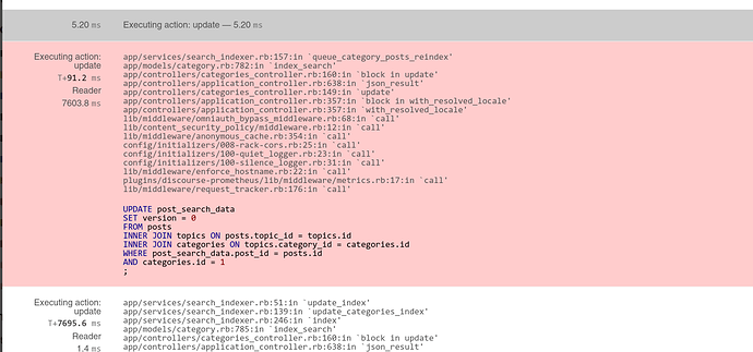

Summary:
Something during category renames is touching every topic or every post and causing the operation to time out.

28
It looks related to the search stuff? That will indeed be very costly and should be moved into a background task.

35
It is this:
@tgxworld can you kick all the search work including setting version to 0 to a background job?

10 Mi Piace
This appears to be fixed in the latest update. Thanks team!
