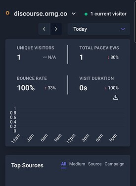

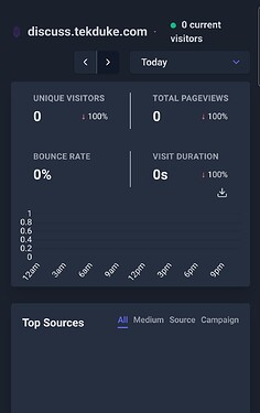

I switched from plausible.hash.js to plausible.js for one of my two discourse sites and this is what happens when I do that.
The site is opened in another tab and it shows no activity at all
Here is my other site with plausible.hash.js which correctly shows 1 online and generally, correct pages are also shown in the top pages widget.
I’m happy to try out any troubleshooting in case it helps eliminate need for the hashed js
