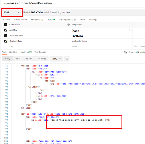

'/admin/users/{id}/log_out.json' לא עובד לא כשורה
I trying to make a sample code for LogOut
My site dns is ‘aaa.com’, and User ID is ‘1’.
I made url and send request like this.
-post AAA Sorry Page
Also, I send header with api-key, api-Username.
But I recived response to “Oops! That page doesn’t exist or is private.”
I trying to ‘CURL’, like this.
But I got same result. (Oops! That page doesn’t exist or is private~~~ )
curl -X POST " AAA Sorry Page "
-H “Content-Type: multipart/form-data;”
-H “Api-Key: secretStringTemp”
-H “Api-Username: system”
-F “id=1” \
Could you help me what am I wrong

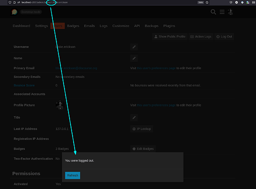

I’m still able to log out users via the api. Here is the curl command I used:
curl -i -sS -X POST "http://localhost:4200/admin/users/1/log_out.json"  \
-H "Content-Type: multipart/form-data"  \
-H "Api-Key: 64b901d2357526d1b6e8c439fd0570f9c585073e6160ae18cc82b7ac358d4893"  \
-H "Api-Username: blake.erickson"
HTTP/1.1 200 OK
{"success":"OK"}
If you are still having issues, can you share more info about your api request with us?

Interestingly, when I send a cURL request to the log_out endpoint for user id 1…
curl -i -sS -X POST https://community.site.com/admin/users/1/log_out.json
-H "Api-Key: my-api-key"
-H "Api-Username: Sean"
…I get a 200 response, suggesting that the user 1 (me) should be logged out of the forum, but when I check, I haven’t actually been logged out - that’s issue one.
Second problem is that sending the same request from my app backend using axios (detailed above) results in a 404…very strange.
Edit:
Issue one is not an issue - the cURL request is successfully logging me out - just need to work out now why the axios post request is giving me 404.

Hi Sean,
Can you please share the log_out.json code since I am working on a similar request
I have tried logging out forum with post api ‘admin/users/{user_id}/log_out.json’ but it returns with Oops! That page doesn’t exist or is private.
I have provided api_key and api-username with in headers. Does anyone faced same issue
