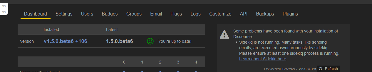

After a clean install : Sidekiq error
I am using a linode 1gb ram setup
The installation/upgrade process goes clean but i get this error in mysite.com/admin (dashboard)
Can you post the full logs from ./launcher start yourapp? Need more information to figure out what is going on :wink:

I am getting this with the latest update! on a Digital ocean 2GB cloud as well.
Updated discourse via ./launcher rebuild app

I also get this after upgrading a few minutes ago:
Visiting /sidekiq works
I’m getting this on my server as well (on commit fa66878 from this morning). /sidekiq is still there, but jobs are queueing up without being completed.
@codinghorror, @eviltrout (sorry not sure who on the team handles this sort of thing), just want to make sure you guys know this isn’t just a new installation issue. If the categories page is any indication, it’s happening here on Meta as well.

Did any one get a fix for this?
I’m looking into it right now.
3 « J'aime »
Okay looks like a recent commit broke a forked version of sidekiq.
I’ve reverted the commit and it’s working again now on tests-passed. The commit will be fixed before being un-reverted.
3 « J'aime »
My bad… I renamed a bunch of files and forgot one spot:
https://github.com/discourse/discourse/commit/a3ba564b03c3390de9761787f479fb81dda03c34
Apologies
4 « J'aime »
