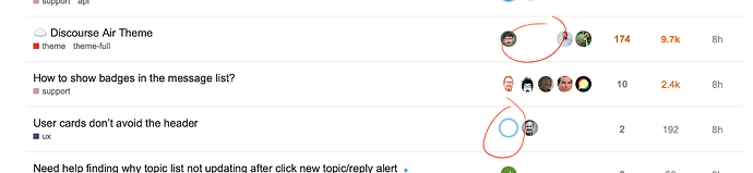

It seems like as of recently, users who sign up (edit: or maybe just have the “system avatar” but not cached in my browser) don’t get the typical colored-character system avatar, instead they just get a white / nothing picture. In some cases it seems like it loads, refreshing asynchronously. I see this on my instance, but also here:

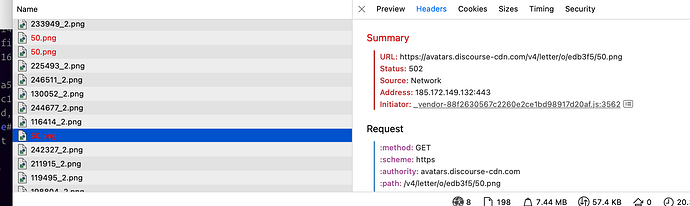

A fire/explosion in the vicinity of the datacenter where the avatar service is hosted has caused the outage. We are working on getting everything back online.

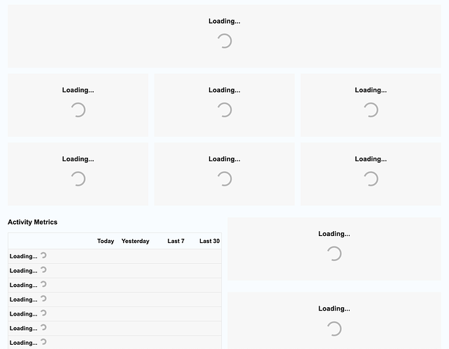

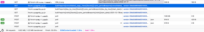

I have seen the same problem (admin reports not loading) this morning. The logs show lots of timeout errors in the avatar proxy service and the version check job. I wonder if that is causing other background tasks to be delayed, including the generation of reports.
The fact that avatars are being proxied through nginx, and those are now taking 15 seconds to timeout instead of milliseconds to load can under some circumstances seriously saturate your nginx capacity, resulting in errors in other, unrelated, requests as well.

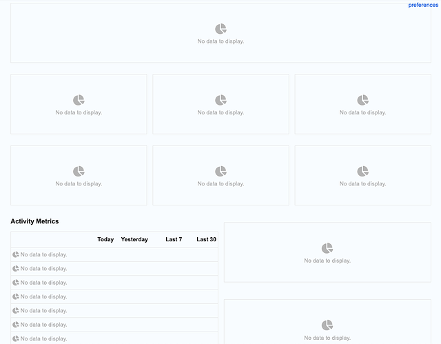

It took me some time to realize this is a forum setting. Can report that disabling external avatar service does not help admin dashboard modules to load.
