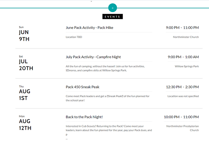

I saw another post that said to post here for some reason about calendar but I don’t think discourse has anything to do with this problem but our post get closed after 7 days so YOLO !
o looking at the .ics file spec I don’t know what one we need but we are missing these … its
  1. X-WR-TIMEZONE
  2. TZID
  3. X-LIC-LOCATION
so I think the timezone setting in the pack should be pulled and it should add X-WR-TIMEZONE to match … when you import from google it assumes your local … but godaddy I can’t find for the life of me where to set that … and it worked before because I assume the old ics calendars had timezone info
