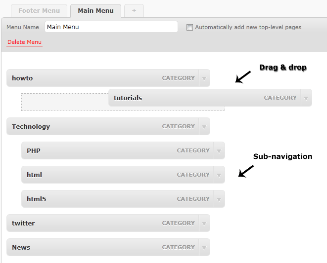

  3. drag-&-drop for reordering would probably be more intuitive than arrows

I’m not so sure about that, drag and drop interfaces can be incredibly annoying especially with very long lists. Some sites may have dozens of categories, and scrolling while dragging and finding the correct place to drop can be frustrating. If I have a list of 50 items and I want to move item 49 to position 1, it’s much easier to use the number input.
7 个赞
I see you point about handling a large number of categories. OTOH, typing numbers to move a list item feels like MS-DOS era. How about drag-and-drop and a move-to-top button?
My definition of an efficient UX is, that it should speed up (fewer clicks, simpler input)
the most common actions, while providing an extended set of actions for less common tasks.
All while providing excellent visibility and avoiding clutter.
Per this definition, clicking a move-to-top button is a simpler action than typing a number, so it would work faster in most cases. There’s also a question of smart phone compatibility, where drag-and-drop beats any numerical input.
And then, there’s Discourse own motto: “Born mobile, born to touch”.

A simply approach to ease this up, without implementing a nice UI for reordering nested categories, might be to simply split out the subcategories:
  • Completely hide the subcategories from the reorder dialog by default, only allowing the top-level categories to be ordered.
  • On top, add a dropdown:
    Reorder | Main Categories          ​  v |
            | Sub-Categories of Feature    |
            | Sub-Categories of Bug        |
            | Sub-Categories of Howto      |
    When the user selects a category in the dropdown, the list below only shows this categories sub-categories, allowing them to be reordered.
4 个赞
