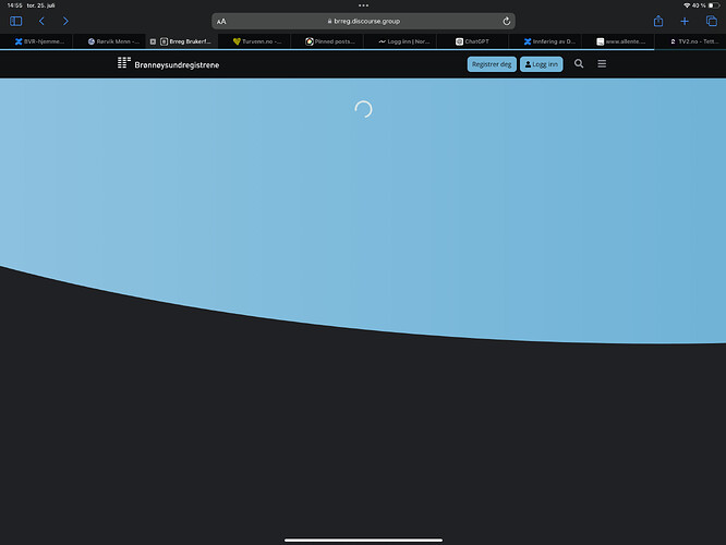

This happens first time an anonymous user tries the old domain - this time just loading, not even a message that the site doesn´t exist

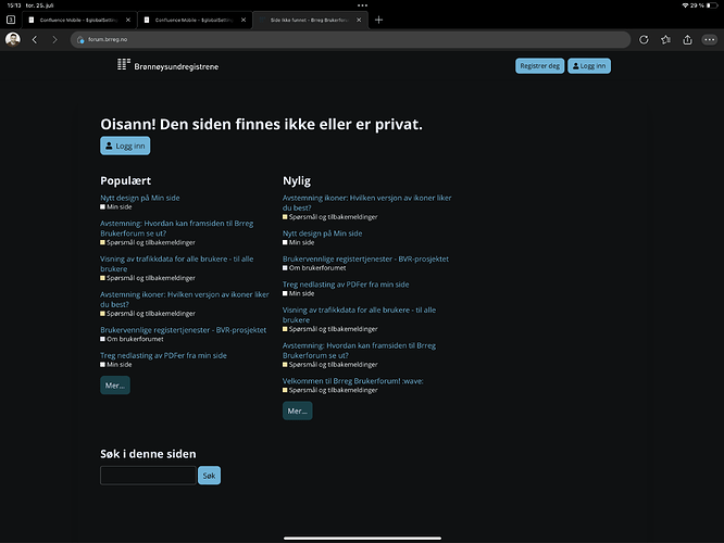

And this was the result when I as an admin tried using my iPad. The text says that the site doesn´t exist.
How is Discourse itself handling the redirect? Why not just add a DNS redirect?
Ah, that looks like you’re trying to access a restricted area while not logged in. If the site wasn’t available it wouldn’t be able to show that error page.
