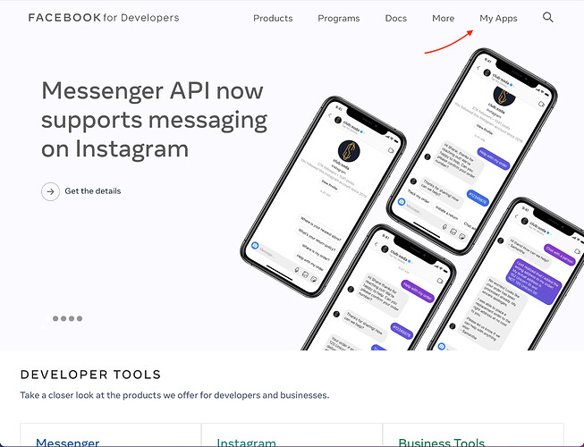

Go to https://developers.facebook.com/. You’ll be prompted to log in to your Facebook account if you aren’t currently logged in. You may be asked to ‘convert’ your Facebook account to a developer account if you haven’t done so previously. You may be asked to verify your account with Facebook by adding a phone number or by completing other steps. You’ll need to just follow the prompts and do what Facebook requires of you.
Once you have a Facebook Developer account, click on ‘My Apps’ from the Facebook Developer homescreen:

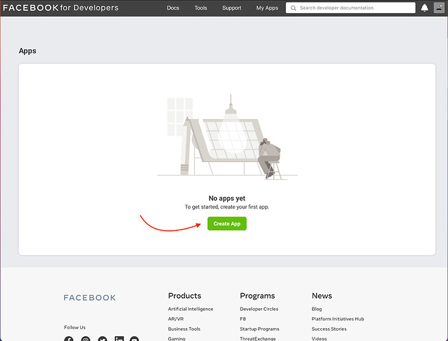

…and ‘Create App’:

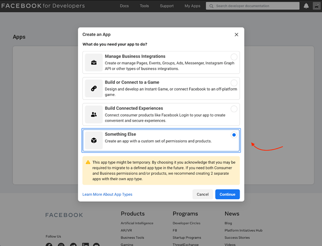

Select an app type of ‘Something Else’ and ‘Continue’:

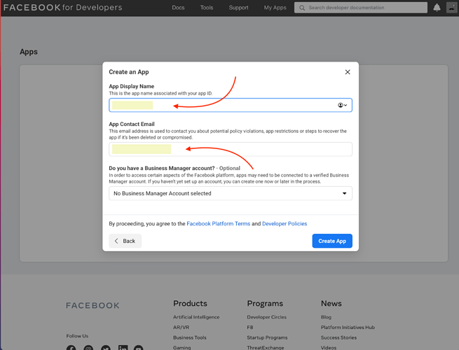

Enter an ‘App Display Name’ and an ‘App Contact Email’. Once you’ve read through their Terms and Polices, you can click ‘Create App’:

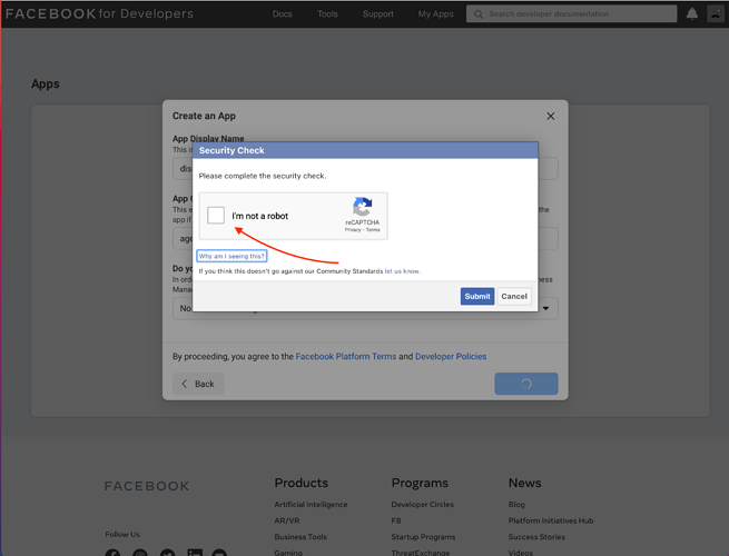

If you are a robot: nothing to see here. Beep bop boop. :robot:
If you are not a robot: click “I’m not a robot”, follow the prompts, and click ‘Submit’.

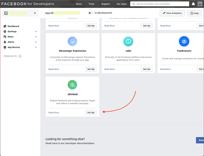

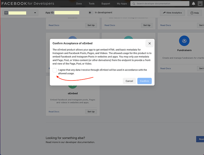

Scroll to the bottom of the list of Products, find ‘oEmbed’ and click ‘Set Up’:
If you agree with how you’re going to use the oEmbed product, click the checkbox, and then click ‘Confirm’:

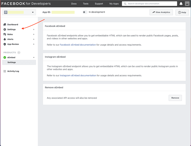

The oEmbed product has been added. Click on ‘Settings’:

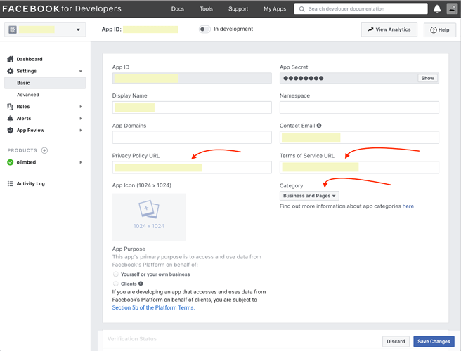

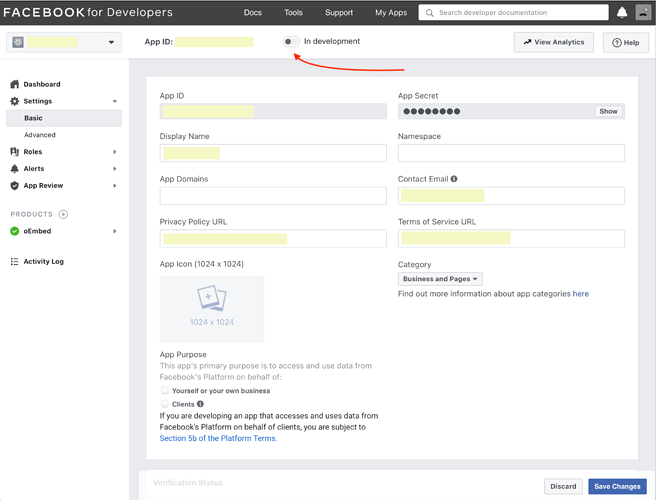

‘Display Name’ and ‘Contact Email’ should already be filled in. You’ll need to enter URLs for your ‘Privacy Policy’ and ‘Terms of Service’. Select a ‘Category’ from the list of available options. Click ‘Save Changes’ when you’re happy with everything:

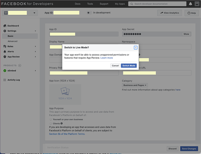

Click the toggle at the top of the screen to change from ‘In development’ to ‘Live’ mode:
Click ‘Switch Mode’:

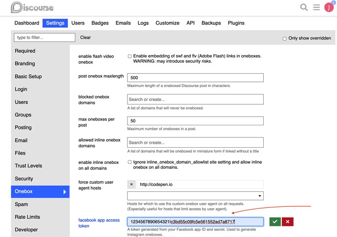

Having done all that, we can actually generate an App Token by following Facebook’s instructions on App Access Tokens. You’ll need the value of the ‘App ID’ field, and the value of the ‘App Secret’ field. To get the App Secret, click ‘Show’. You may be asked to reauthenticate yourself or similar, but you should end up with a long hexadecimal value that you can copy:
As per Facebook’s documentation, you need to send those values to Facebook to generate a token. Are you familiar with using curl? Great! They suggest the following (replacing {your-app-id} and {your-app-secret}) with the values you copied from the screen above.
curl -X GET "https://graph.facebook.com/oauth/access_token?client_id={your-app-id}&client_secret={your-app-secret}&grant_type=client_credentials"
Alternatively, copying just the URL (after replacing those two values) to your browser should also work:
Facebook will respond with a small chunk of JSON, that should look something like this example:
{"access_token":"1234567890654321|c3bd55c09fc5e561552ad7a8717","token_type":"bearer"}
Copy the value of your access_token, excluding the quote marks (i.e., in my example it would be 1234567890654321|c3bd55c09fc5e561552ad7a8717), and go to your Discourse site’s Settings. Find the site setting called facebook_app_access_token in the Onebox setting. Paste the ‘access_token’ value in to this field:
Click the :white_check_mark: …and you’re done!

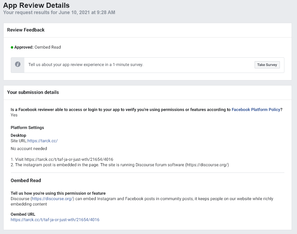

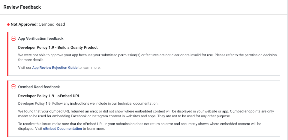

New rules from our Facebook overlords, I’ve just submitted both of my apps for review. I found a public post with an Instagram embed and linked directly to show how the integration works. Hopefully this is sufficient.
8 « J'aime »
womp womp, review failed.
here’s what i submitted
Your submission details
Is a Facebook reviewer able to access or login to your app to verify you’re using permissions or features according to Facebook Platform Policy?
Yes
Platform Settings
Desktop
Site URL:https://fixed.org.au/
No account needed
  1. Visit The 'what you've done to your bike today' thread - #10218 by jaseyjase - Post your ride - FOA
  2. The instagram post is embeded in the page. The site is running Discourse forum software (https://discourse.org/)
Oembed Read
Tell us how you’re using this permission or feature
Discourse (https://discourse.org/) can embed Instagram and Facebook posts in community posts, it keeps people on our website while richly embedding content
Oembed URL
I just resubmitted (had some extra text in Oembed URL) and it’s been approved!!! :smiley: waiting for my second app to be…

The first review failed because I had some extra text in the Oembed URL field and the form removes spaces onsubmit, so the URL didn’t work… That’s the only difference between attemps
Nope, in the Platform section (I had to add a platform in the wizard), I just wrote
No account needed
I didn’t really want to setup a discourse account just for FB review, so I just found a post on our forum that was public, and had an Instagram image embedded. I thought this would show how the integration functions well enough. I guess FB could read the discourse source and work it out themselves :man_shrugging:
Sorry I missed this. I literally did no changes to either forum, just found a forum post with an instagram pic embedded as mentioned above and then walked through the app review wizard on FB

Hi @znedw, I followed your guide and got our app review approved 24 hours later.
Although, I had to enter the direct link to the embedded Instagram post into the oEmbed-URL field as the form did not accept the link to the topic on our domain in that field. Maybe they changed that part.
For the rest, I followed exactly your wording. And it worked.

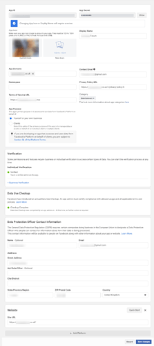

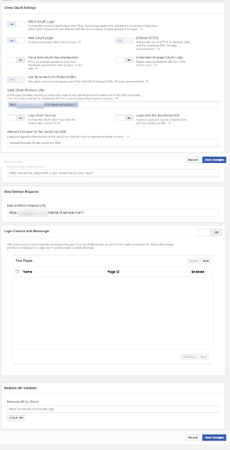

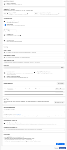

Ça fonctionne maintenant sur mon compte. Je vais essayer de résumer ce dont vous avez besoin. Je ne suis pas particulièrement calé en technologie, donc je ne suis pas sûr de pouvoir répondre à de nombreuses questions, mais je suppose qu’il suffit de copier mes paramètres aussi fidèlement que possible pour vérifier que tout fonctionne.
Vous avez besoin de la connexion Facebook (je ne sais pas si l’API Instagram Graph est réellement nécessaire). Vérifiez que la connexion Facebook fonctionne sur votre installation Discourse.
Paramètres de connexion Facebook :
Paramètres de base :
Paramètres avancés :
3 « J'aime »

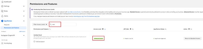

Salut tout le monde, je voulais vous informer qu’à partir d’aujourd’hui, la description de @Iceman reste exacte.
Certaines mises en page ont été modifiées par rapport au guide (:point_up:), mais la principale différence est que oEmbed doit être demandé après que votre application ait passé l’examen de l’application.
Depuis le menu « Examen de l’application », vous pouvez faire des demandes :

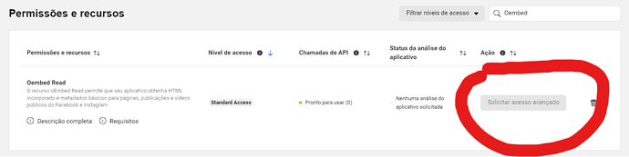

Mon accès a été révoqué car il n’a pas été utilisé pendant 90 jours. Ce qui signifie, je pense, que personne sur mon forum n’a récemment posté de lien Instagram.
Voici donc l’état actuel de la permission oEmbed Read :
Pour demander un accès avancé à cette permission, vous devez effectuer un appel API de test réussi. Il peut s’écouler jusqu’à 24 heures après le premier appel API pour que ce bouton devienne actif. En savoir plus sur les tests
Comment, en pratique, faisons-nous un appel API avec Discourse dans ce contexte pour demander à nouveau un accès avancé ? :thinking:
