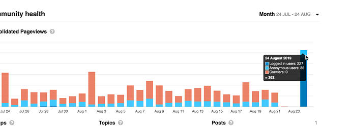

I was just wondering about a similar thing. I just updated to beta 9 and saw the following:
It’s telling me I have way more logged in users than even exist on my forum. Where’s this data gathered from?
That is Logged in users PAGEVIEWS, as one user can have hundreds of pageviews in one day.
Cheers. :person_facepalming: That’s what I get for not reading carefully enough. Stupid mistake on my part.
Apparently that text is not that intuitive.

Pour moi, cela affiche 227 utilisateurs connectés, mais j’en ai moins de 100 d’inscrits sur le site. Est-ce que je l’interprète mal ?
C’est bien cela. Pas le nombre d’utilisateurs connectés ce jour-là.
