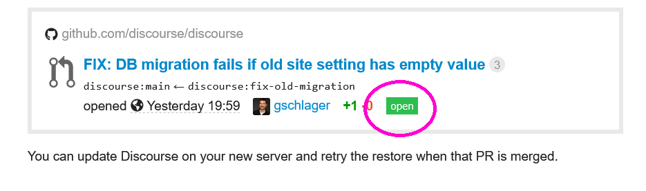

Вот лог, начиная с этапа миграции базы данных…
Migrating the database...
EXCEPTION: /var/www/discourse/lib/discourse.rb:121:in `exec': Failed to migrate database.
rake aborted!
StandardError: An error has occurred, this and all later migrations canceled:
PG::InvalidTextRepresentation: ERROR:  invalid input syntax for type integer: ""

/var/www/discourse/db/migrate/20160302170230_rename_digest_after_days_to_digest_after_minutes.rb:7:in `up'
