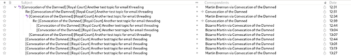

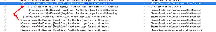

Okay this is kind of huge, please bear with me. First, thanks for another detailed reply and the offer of debugging / review, it is really helpful :+1: I’ve actually been looking into this this morning and, surprisingly, the threading in a unified view works in Thunderbird for most cases, and I think the References header consistently pointing to the OP helps with that (for example the topic Reference in this chain which is always present is <topic/53@discoursehosted.martin-brennan.com>.
The case where the threading does not working as intended is:
  1. A post is created within discourse and an email is sent out to those watching the topic then
  2. Someone else replies to that post and an email is sent out to those watching the topic
In the case of the second email, it gets an incorrect In-Reply-To and References header since it generates one on this line discourse/lib/email/sender.rb at 98bacbd2c6b9fe57167cd32af5eb4839b4a5d1f6 · discourse/discourse · GitHub rather than using an existing one. It should be using the Message-ID for the email that was sent first. In the screenshot, this is where the messages following this pattern should be placed:
The answer is – it depends. If a post is created in Discourse from an inbound email, such as this one of yours, we use that post’s original inbound Message-ID when someone replies to it for the In-Reply-To and References headers as per:
Otherwise we are just using the topic OP reference and just generating a new reference, which obviously is what is causing all the issues. In all cases we generate a new Message-ID every time an outbound email is sent, which seems correct and on par with other mail clients.
I think I see what you mean, does it go like this:
  1. cameron sends email to Discourse from mutt which gets Message-ID: 74398756983476983@mail.com
  2. Discourse creates a post and stores the Message-ID with against the post with an IncomingEmail record
  3. johndoe is watching the topic, so they get sent an email from Discourse with a Message-ID: topic/222/44@discourse.com and no reference to the original Message-ID: 74398756983476983@mail.com
Does that sound correct, that we should just “pass on” that Message-ID to those watching the topic instead of generating our own since it’s already unique? What then happens in johndoe’s mail client if
cameron also CC’d him on that original outbound message? This does sound like a separate issue so it would be good to open another bug topic for it.
I will set up a mutt client locally to see what you are also seeing, I have never tested this functionality in a text-based client (only Gmail and Thunderbird) so I am keen to see how it looks anyway.

Interestingly there seems to be some threading there.
But notice: the top post has a little “is a reply” arrow. Even though it
is post 1. I expect that is because of the “topic” references entry,
which make TB think there was a earlier message (which of course there
was not).
