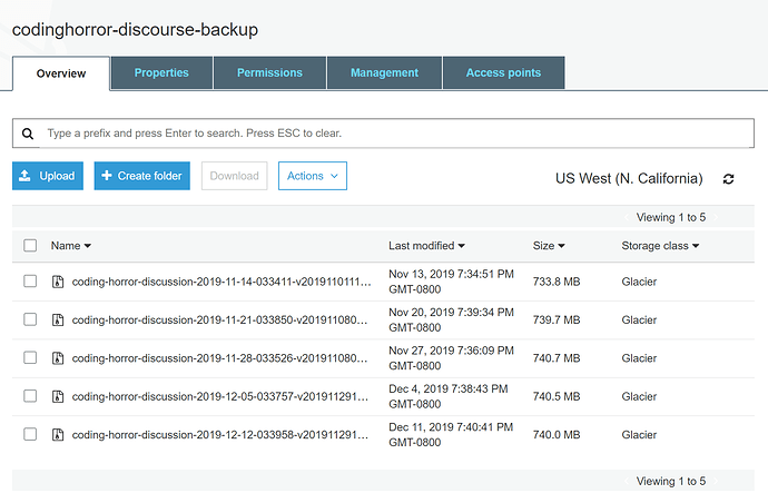

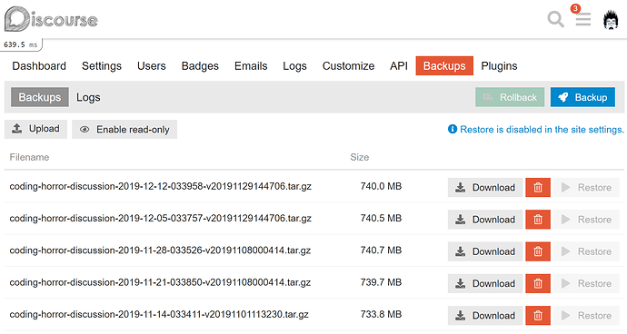

I have no issue with AWS S3 backups on my self hosted instance:
