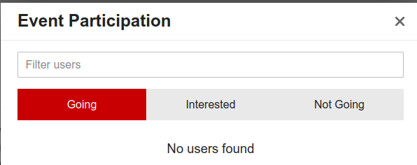

Thanks. I have upgraded and confirm the reported issue is addressed. However, a related issue persists…
If you click the ... box, “Show participants” still exists and it leads to Event Participation. “Show participants” shouldn’t be an option.
Ah, that is a good catch. This only shows up for those who can act on the event, but I will make a PR to remove this from standalone events.
https://github.com/discourse/discourse-calendar/pull/679
Just confirming Show participants appears for moderators and admin but not my regular users.
The latest PR should address this for even admins & moderators now.
