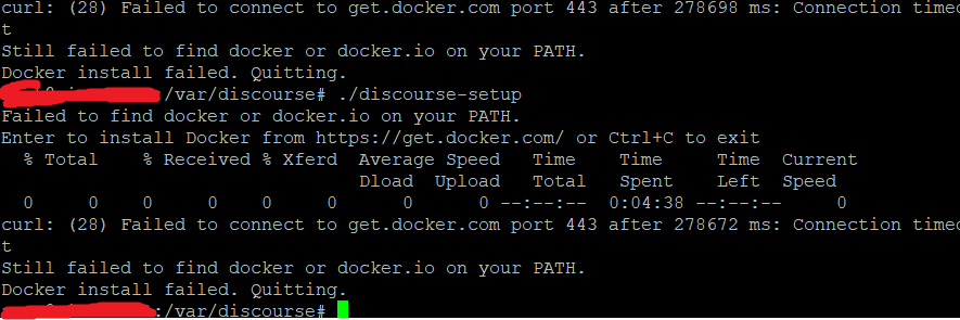

So instead of doing the 1 click app on digital ocean, im following this guide: discourse/docs/INSTALL-cloud.md at main · discourse/discourse · GitHub
I’m getting the following error:
anyone know what I can do?

You can run sudo apt install docker.io to install docker on the given system.
Hope this helps!
thanks that worked flawlessly!

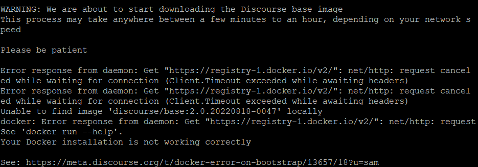

It appears that you aren’t connected to the internet. Could you try running ping google.com? Are you hosting this in the cloud, on a vm, or on bare metal?
Interesting. Could you try curling https://get.docker.com/ by using the command
curl -v https://get.docker.com/
Idk why, but I restarted putty and did the same discourse install command and it seems to be installing now
Alright! Glad you got it figured out. ![]()
Let me know if you need anything else.
