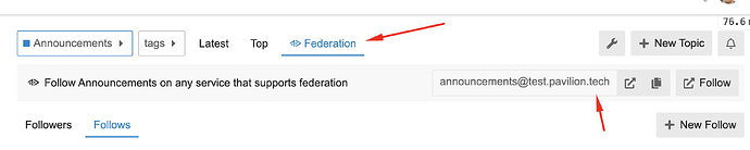

Discourse
Obtain the handle of a Discourse Actor by going to the “Federation” tab in the topic list view of the Actor.
The handle in the screenshot is announcements@test.pavilion.tech

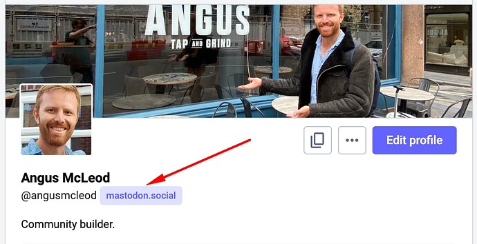

Mastodon
Obtain the handle of a Mastodon Actor from the Actor’s profile
The handle in the screenshot is @angusmcleod@mastodon.social
