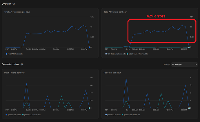

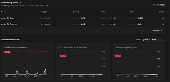

  2. How does one limit the rate of the embedding API’s? I’ve had to reset the embedding model due to the deprecation of the old model from Gemini so now it’s trying to generate new vectors for the entire forum (if I understood your other post correctly). The problem is that it’s doing it way too fast and it’s hitting 429 too many request rejections from Gemini. Is there a way to throttle it? I’m within the RPD/TPM limits but the Gemini dashboard is showing that discourse is hitting the API way too many times. Would appreciate any advice you may have here (everything was working fine until I had to create a new embedding model due the deprecation of Gemini’s old model).
All well within rate limits:
but getting a lot of 429 (too many request) errors:

On a side note, this appears to be the batch size, how many requests in a single call. Perhaps the issue is that number of requests being made per minute (not per batch). Is there a way to throttle how many backfill requests are sent per minute or per hour?
Also found this if it helps other users, the new gemini embedding is having issues with limits set to 0 if exceeded. There’s a temp workaround to using text embedding instead or maybe just wait for a bit and see if resolves. Having said that I still think it’s a good idea for discourse to add an option to limit the number of API calls per minute for backfills to avoid this problem in the first place.
