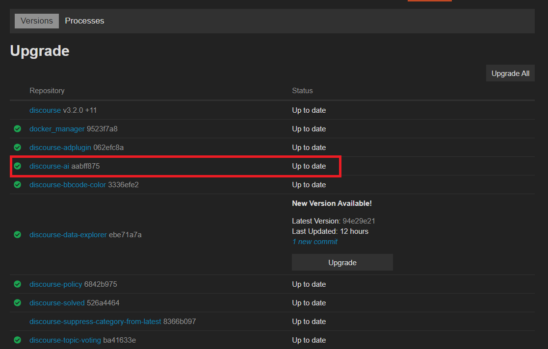

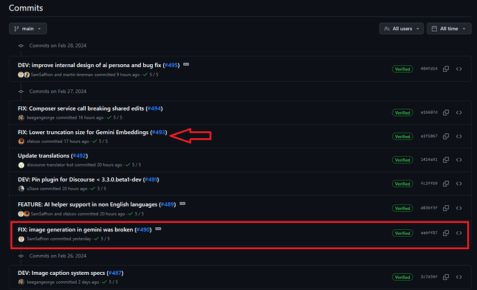

Unfortunately that doesn’t seem to be working. I’m still seeing the number of errors Job exception: Net::HTTPBadResponse going on increasing. I’ve tried to restart the system, verified in rails the number backfill batch is set to 50. What else can I do/check here?
Yes

Ok, I updated the discourse plugins from the admin upgrade panel. Unfortunately it’s still throwing errors:
Message (1397 copies reported)
Backtrace
/var/www/discourse/plugins/discourse-ai/lib/inference/gemini_embeddings.rb:17:in `perform!'
/var/www/discourse/plugins/discourse-ai/lib/embeddings/vector_representations/gemini.rb:46:in `vector_from'
/var/www/discourse/plugins/discourse-ai/lib/embeddings/vector_representations/base.rb:178:in `generate_representation_from'
/var/www/discourse/plugins/discourse-ai/app/jobs/scheduled/embeddings_backfill.rb:125:in `block in populate_topic_embeddings'
/var/www/discourse/plugins/discourse-ai/app/jobs/scheduled/embeddings_backfill.rb:122:in `each'
/var/www/discourse/plugins/discourse-ai/app/jobs/scheduled/embeddings_backfill.rb:122:in `populate_topic_embeddings'
/var/www/discourse/plugins/discourse-ai/app/jobs/scheduled/embeddings_backfill.rb:36:in `execute'
/var/www/discourse/app/jobs/base.rb:297:in `block (2 levels) in perform'
/var/www/discourse/vendor/bundle/ruby/3.2.0/gems/rails_multisite-5.0.0/lib/rails_multisite/connection_management.rb:82:in `with_connection'
/var/www/discourse/app/jobs/base.rb:284:in `block in perform'
This solved the problems on my install, are you sure you updated after the PR was merged? And that the errors are after that change was merged?
Hmm, updated it last night from the Admin Upgrade panel. This is what it’s showing as of now:
The PR commit is pointing to aabff87
Your commit is 4 commits after this at a1f1067 but discourse is saying that the Plugin up to date. I’ve even tried restarting the machine but it’s still saying the plugin is up to date.
Do I need change the branch or something? How do I force discourse to install the latest commits to plugin?
Are you running Discourse at the stable branch by any chance? That will lock the plugin at an old commit. I don’t recommend using the AI plugin with stable, too much moving parts necessitate new core hooks.
Moving to tests-passed seems to have upgraded all the plugins and fixed the issue.
