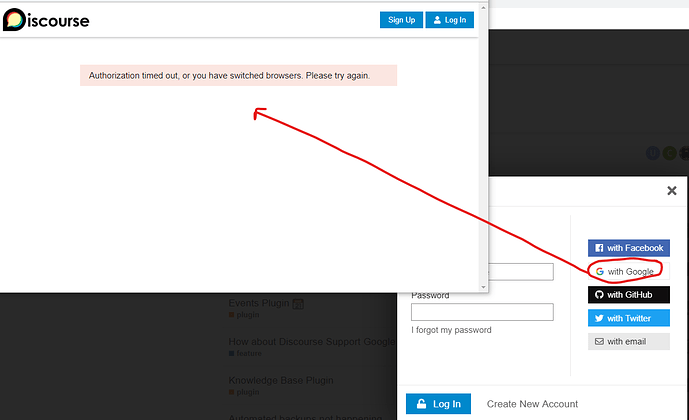

Hello,
I have tried to login via google chrome which is the browser I always use and I get this * authorization time out*
Help appreciated

Do you mean here on meta? You can’t log in here on meta via Google?
2 « J'aime »
Yes. I do. It only happens on some devices.
What devices are those and what Os / browser?
1 « J'aime »
Device: phone, does it on the occasion
Computer
Browser is Google chrome.
It could be on my side. I’ll try to find a solution

I’m getting this same error on https://discourse.codinghorror.com/.
2 « J'aime »
Hmm you’re right, I can repro this everywhere @eviltrout we need to urgently look at this.

Hello.
I am facing Social Login /auth/failure problems that described very clear in the following screenshots. I don’t know if these are bugs of the new Latest 2.4.0.beta3 or not. Does any-one have solutions to get rid of troubles? Many thanks in advanced!
https://applehint.com/auth/failure?message=csrf_detected&strategy=google_oauth2
https://applehint.com/auth/failure?message=request_error

I’m looking into it right now.
6 « J'aime »
Okay we discovered the issue was with this commit:
It’s been reverted and we cut a new beta. If you upgrade your Discourses the issue should go away. We will investigate a new fix for Safari and cookies.
