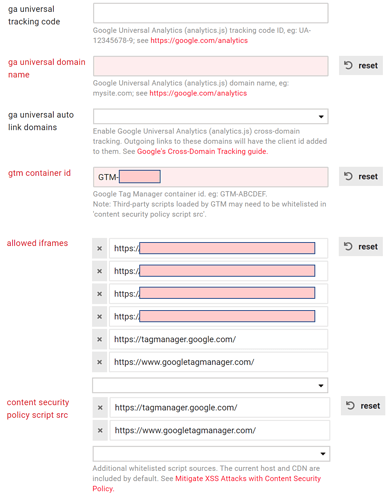

I tried to use the GTM guide to track Universal Analytics on our forum. We have previously used the standard GA function. This has worked previously (though it only appears to work for users who are logged in).
I am an experienced GTM user (though admittedly far from an expert) and I followed the guide for setting up with Google Tag Manager [Setup Google Tag Manager for Analytics]. See below:

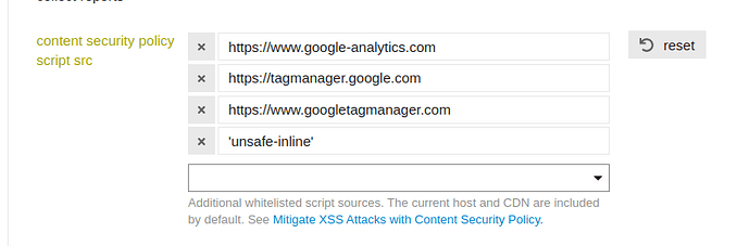

Are you seeing a Refused to execute inline script error in your browser’s console? If so, adding 'unsafe-inline to your content security policy script src setting should fix the issue. Here how that setting is configured on my test site:
The GTM debugging tool is working on my site.
3 curtidas
Hi Simon, thanks for your reply.
I tried this initially and it made no difference, so I decide I would send it off as a question to a developer. Then, before sending it off I tried it again and it worked, so I guess the system just needed some time to process the changes. Thank you for your advice, it worked!
