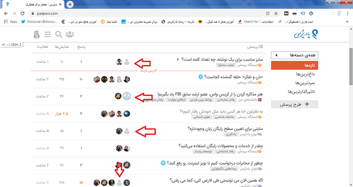

we have faced an issue similar to this bug :
https://meta.discourse.org/t/missing-user-profile-pictures/93844
is there any way to recover the missing avatars?
p.s.: I tried to use this guide and ran rake avatars:refresh but nothing happened.

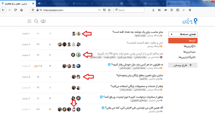

this problem is like a virus and spreading towards more avatars! a strange observation was this:
in the firefox some avatars are shown, while they are missing in the chrome. this doesn’t mean, in firefox no avatar is missing. there are missing avatars in firefox as well!
has this bug really been fixed?
