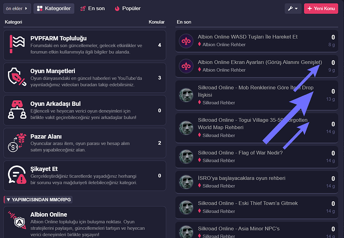

Hi helpful friends,
How to add three dots at the end of the topic name?
Full topic name : Lorem ipsum dolor sit amet, consectetur adipisicing elit, sed do eiusmod tempor incididunt ut labore et dolore magna aliqua.
I need to do : Lorem ipsum dolor sit amet, consectetur adipisicing elit, sed…
I want it to work only on the home page.
The reason I want this is to keep the topic lengths the same on the homepage.
Thank you :pray:
