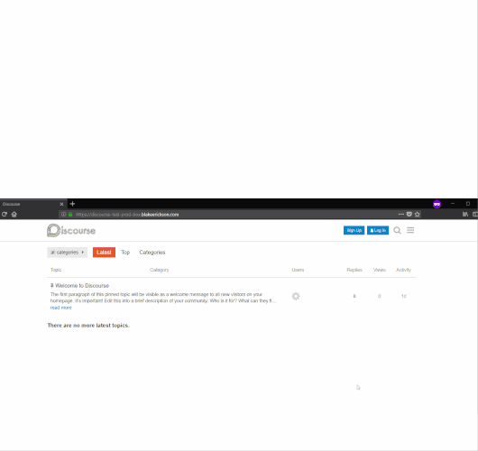

Ecco una gif in azione:

Is this still an issue? I know your edit says fixed, but then you say there is another issue and I don’t understand what that is?
Either way, once I got everything working again creating a user with an already logged in auth0 user works just fine:
