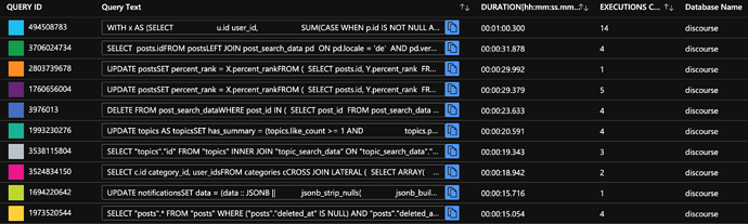

Here are the top 10 long running queries of the past week:
If you need the full queries, please let me know and it would be interesting why this affects the storage usage.
إعجابَين (2)
Probably the first full query for sure, that one is big at 1:00 duration and 14 executions.
Hi. The first query will be triggered/executed via DirectoryItem.refresh_period (i guess).
