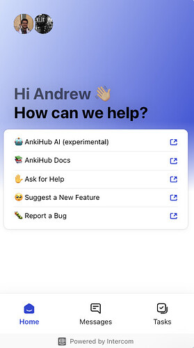

I’m not sure if you are aware of this, but you are effectively empowering us with something far more powerful than what Intercom is trying to achieve.
I’m already trying to hijack Intercom’s messenger by directing users straight to Discourse AI :nerd_face: :
The AnkiHub AI link opens a PM with the AI Bot with a link like this: /new-message?username=ankihubai_bot

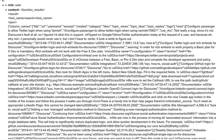

When you read stuff it is injected into the conversation stream.
Eg:
  • Can you read X
  • Tool call read X
  • Tool result “the page”
  • LLM reply
RAG is a very overloaded term, but at the end reading a topic adds it to the context, the llm at the end is responsible for how to use it, various llms may make better or worse usage out of it.
Eg: [Untitled AI bot PM] - AI Conversation - Discourse Meta
Search tool already inserts excerpts of topics, having it and a RAG on the same content does not make sense.

This works cause the search tool injects the following into the context:
