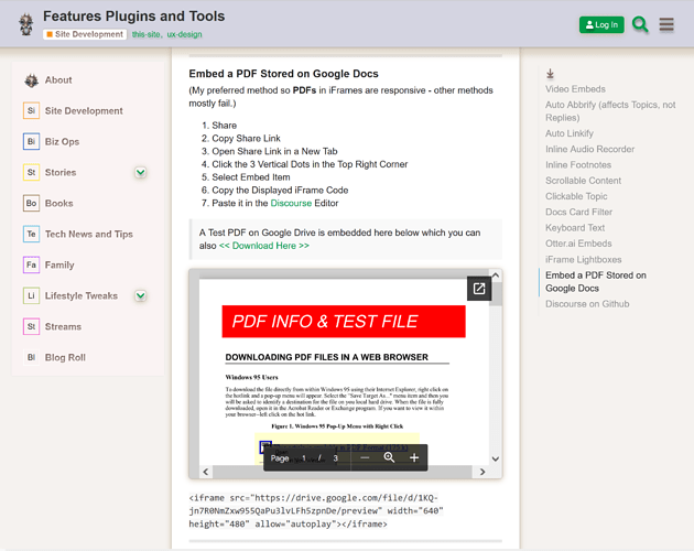

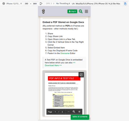

Embed a PDF Stored on Google Drive
PDFs display in Mobile as well as Desktop.
(My preferred method so PDFs in iFrames display in any device as responsive)
  1. Share
  2. Copy Share Link
  3. Open Share Link in a New Tab
  4. Click the 3 Vertical Dots in the Top Right Corner
  5. Select Embed Item
  6. Copy the Displayed iFrame Code
  7. Paste it in the Discourse Composer / Editor
Desktop Example…
Mobile Example…
