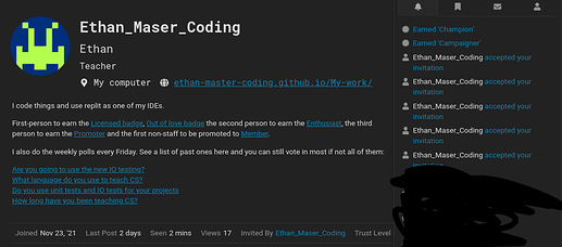

Recently in 2.9.0beta2 users that already have an account can click invite links. But I generated invite links can click them it said I invited myself and because I am TL2+ and I clicked 5 different invite links of mine I received the Champion badge. You can see a screenshot below of it below. These are in the Replit EDU forums and you can view my profile here.

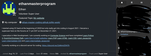

I also made an invite link on the Codecademy forums and it says I invited myself there also that you can see below. View my profile here.

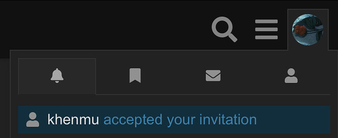

After some extra testing, I am only experiencing this on Replit Ask:
But not on here meta or on another forum, all it says is that Ethan accepted your invitation but does not grant the badges.
