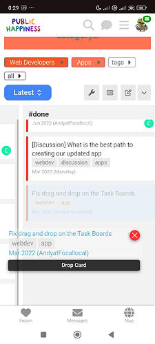

I had a go at the long talked about drag-and-drop mobile feature for the Kanban plugin. I cant see any bugs but i’ve not tested it in depth yet.
I think it’s pretty self explanatory. Long press to pick up a card. Scroll as normal. Click the button to put the card somewhere else.

I just tried your testsite on mobile and tablet and it doesn’t work well at all for me, or I don’t understand the mechanism – sorry to say :confused:
  1. The first problem is it tries to open the preview on long press. Trying to press slightly shorter, doesn’t work of course and opens the topic.
  2. And then it simply does not move after pressing drop either
This is what I’m getting: (I’m targeting the top card titled : “Getting started Guide: App Devs”)
I’m testing on iOS (18.7) – could be a version issue, so I wonder if you have tested on iOS too, or only Android so far?

only android. it was a quick project last night and i havent had time to test so i greatly appreciate you trying it out and sharing the bugs. I’ll try to fix those tonight.
  1. I fixed the same issue on android so it shouldn’t be difficult.
  2. I’ll have to investigate. There should be a modal window checking that you are sure you want to move it, or don’t have the required permission to do so, and that’s not appearing so something is definitely not quite right on iOS.

@chapoi ah, you haven’t logged in so its probably just ignoring your instructions as you don’t have the required trust level to move a card
There should be a pop-up asking you to login though so i’ll add that.

Both should be fixed now. You’ll need to be logged in to test it.
Scrolling while holding a card was a little tricky as it didn’t allowing swiping to navigate on-top of other cards. I’ve just updated the component to improve that.
