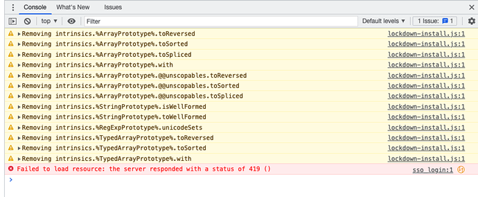

This is error in console:

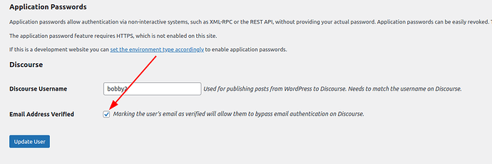

For sites that are using the WP Discourse plugin for authentication, site admins can also mark email addresses for individual users as verified from the user’s preferences page:
This is safer, and easier, than disabling email verification for all users on the site.
