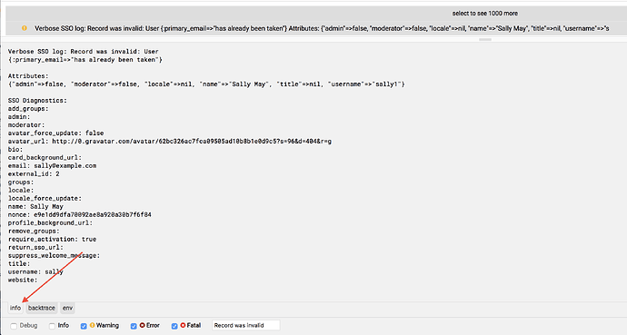

Go to Admin/Logs/Error Logs and look for a recent log entry that starts with Verbose SSO log: Record was invalid. If you have trouble finding the entry, enter ‘Record was invalid’ into the search box at the bottom of the logs page. Click on the log entry. Then click on the ‘info’ tab on the logs toobar:
The information that you will need is the reason (given in the log entry), and the email and external_id (found in the info section.)

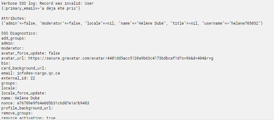

Hi, we tried these solutions but nothing worked… External id were the same and SSO is active. Do you have other solution please? I’m lost :frowning:
Is the problem with SSO login for a particular user, or is SSO not working at all on your site?
only for a particular user
Make sure you have enabled the verbose sso logging site setting. If you have done that, are you able to find the error in your site’s logs when the user attempts to login? If you can share the error log here, we may be able to help. If there is data in the log that you don’t want to make public, you can send it to me in a PM.
2 curtidas
Does this help you? It is what you need?
It is the detail of the Log for member concerned by the situation (or at least, the only one that reported this problem)
Thank you so much!

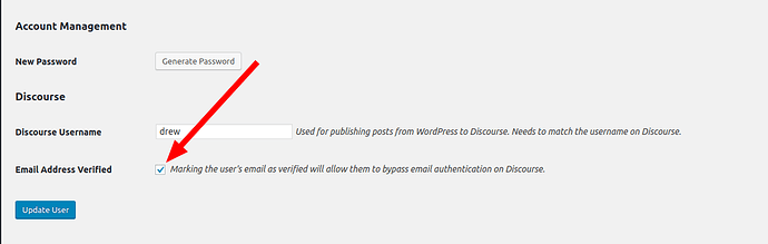

Thanks, that helps. It looks like your SSO provider site is a WordPress site. Are you using the WP Discourse plugin for SSO? If so, and you are using the latest version of the plugin, try going to the user’s profile page and checking the ‘Email Address Verified’ checkbox. Then be sure to click the Save button. After doing this, have the user try logging in again.
If you are not using the WP Discourse plugin, we will need to give you more detailed instructions to fix the issue.
4 curtidas
You’re right, I’m using WordPress and I made the change, I will ask user to try again, thank you so much!! :smiley:
1 curtida
It worked! Yeah! :smile: Thank you!
