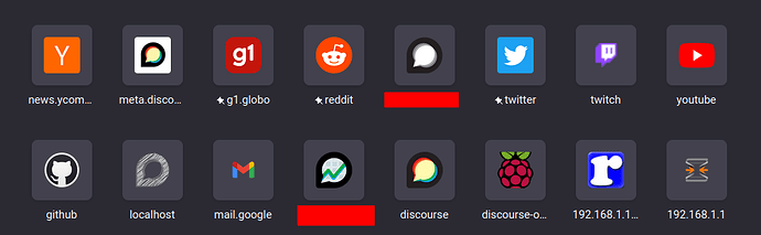

This is my Firefox new tab page now. The white background on the icon is very non-standard from the looks of it
Why would Firefox be using the apple touch icon?? I would expect Firefox to use one of the icons linked from https://meta.discourse.org/manifest.webmanifest.
Indeed, I thought that was why Discourse has two separate settings, “manifest icon” and “apple touch icon,” because Apple ignores transparency and applies rounded-corners masking, whereas other browsers are supposed to follow the Web Manifest standard, allowing transparency.
Both Chrome (Android tab icons) and Firefox (Tab start page) use the apple-touch-icon as a High-DPI version of the favicon, and were both affected by this change.
AFAIK that is only used for PWA features, like the icon when you add it to the homescreen.

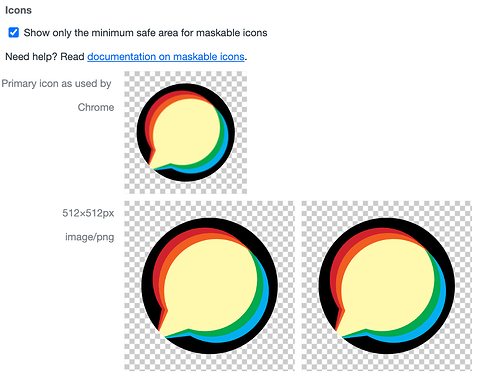

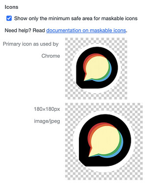

Here’s how Meta’s Manifest panel looks in Chrome Dev Tools when I check “Show only the minimum safe area for maskable icons”
Since the icon is supposed to be maskable, Android/Chrome is taking a circular chunk out of the middle, with poor results.
I tested using the Apple Touch Icon, which @Stephen described as “overwhelmed by a sea of white,” as a maskable manifest icon in Chrome Dev Tools. But even that icon is just barely too large against the standard maskable size… the lower-left corner gets chopped off.
