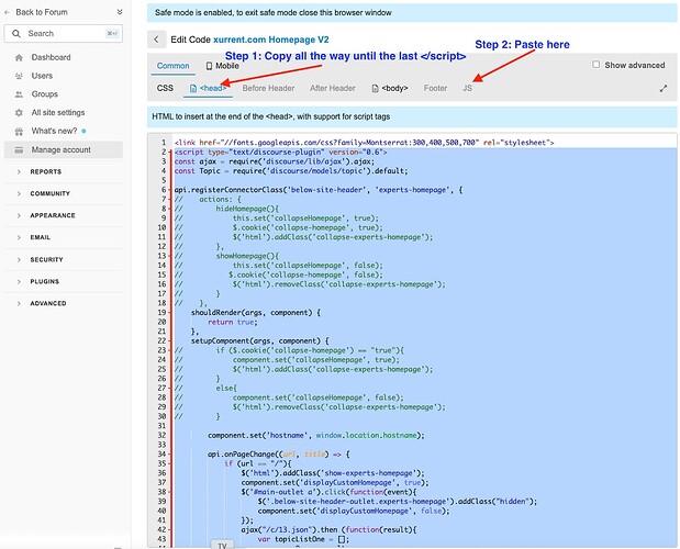

Thank you for this post!
May be a very basic question I believe:
Since we do not have a sandbox, I need to be sure before I proceed.
I have to update a theme affected so am I correct if say that all the code related to ā€œScriptā€ from ā€œheadā€ tab need to be moved into the JS tab as illustrated below:
Almost, but not quite. You’d want to remove the script tags, and change the imports to something like:
import { ajax } from "discourse/lib/ajax";
Then, paste all this in the JS tab, inside:

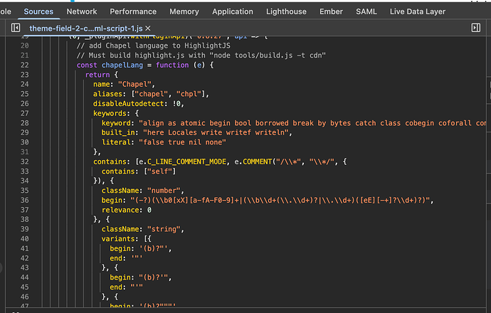

Our Discourse site (hosted by Discourse) is currently generating the following error bar (which is what led me to this thread):
I’m not aware that we’ve done any cutomization of the ā€˜Light’ theme of our own, and looking at its admin page, am not seeing anything suggesting this is anything more than the system-provided default (but could easily be missing something).
For a hosted site like ours, is this likely to self-resolve over time, or does it require some action on our part?
Thanks,
-Brad
You will need to take action to resolve this - it won’t go away on its own.
I took a quick look at your site in chrome dev tools, and it looks like the relevent code is related to adding the ā€˜chapel’ language to highlightjs.
If you visit your ā€˜Light’ theme, and hit ā€˜edit code’, you should be able to find this under one of the HTML tabs. Then you can follow the instructions in the OP of this topic to move it to the ā€˜JS’ tab.

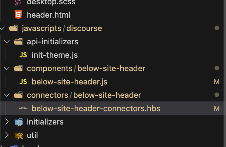

Thank you. I tried and it didn’t work :confused:
This my structure and these are
below-site-header.js
export function test() {
    let test2 = document.querySelector('.test');
    console.log('test ', test2);
And below-siteheader-connectors.hbs
<div class="test"></div>
I’m new to this so any help is appreciated. I took this repo from a previous dev.
Hi there, could you share the link to your Github repo? Thanks!
