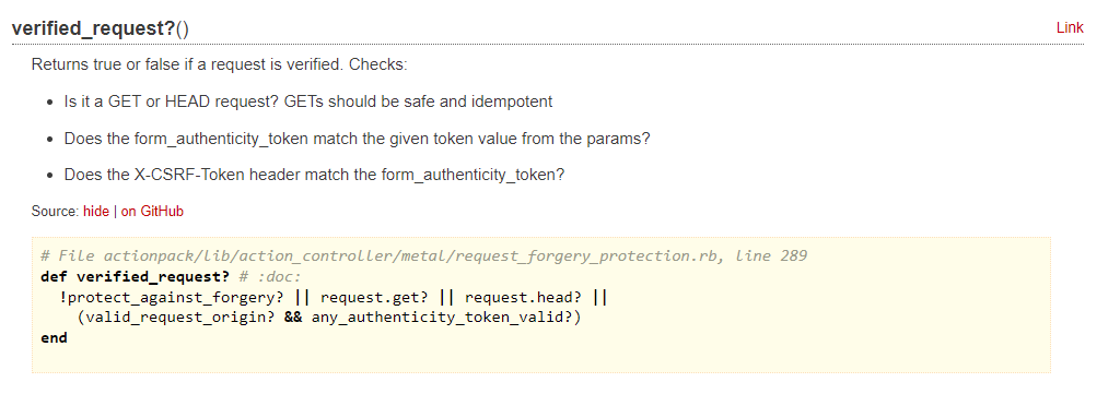

We must be breaking one of these?
I’m still unable to find a pattern. Sometimes it works and connects me correctly, but other times I’m met with the csrf page.
At the moment, I’m most suspect of the last condition check in verified_request?.
Are there any ways to easily check if (valid_request_origin? && any_authenticity_token_valid?) is returning true?

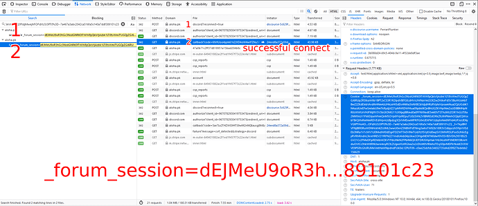

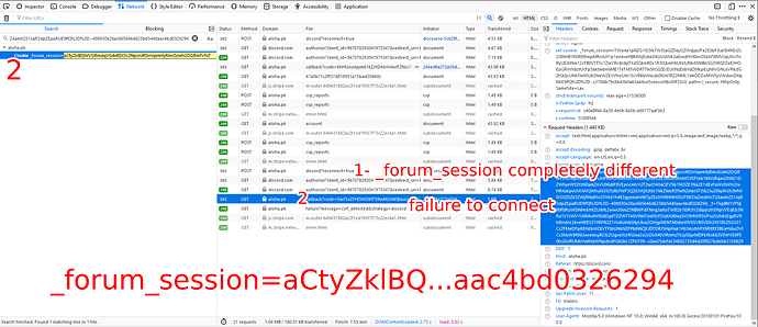

The pictures below show a back-to-back instance where I was able to successfully link my account, refreshed/tried it again, and unsuccessfully hit the csrf detected page. I was in an incognito window and did/changed literally nothing between the successful connect and csrf failure. Here’s what I found:
So this first pic shows the _forum_session cookie matching in both 1 and 2 request headers, which resulted in a successful connect.
However after I reloaded the page and tried again (and failed to connect), you can see my search on the left side only shows 1 occurrence of the _forum_session cookie in a request header when it resulted in a failure.
tl;dr: I’m pretty sure the issue stems from the forum_session cookie in the discord?reconnect request header and then the following callback? request header not matching. What would cause them to be different?

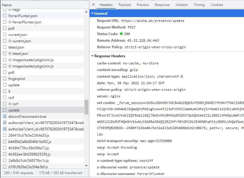

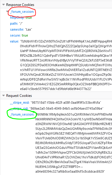

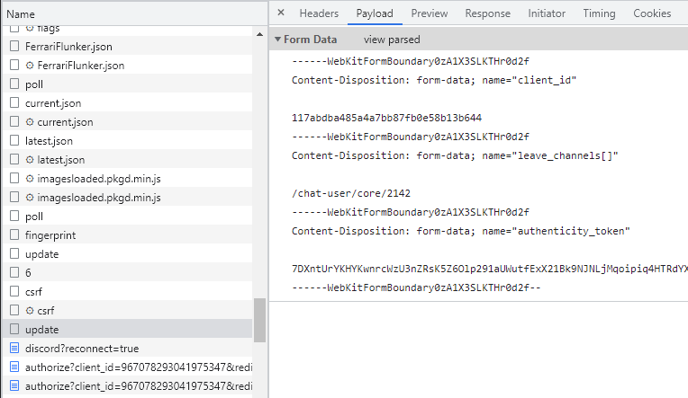

Ok, I think we’re getting closer.
So in this pic below, you can see an update POST request happening directly after the discord?reconnect POST request.
And sure enough, it’s setting the _forum_session cookie which is causing it to mismatch like I described above.
If I check a successful connection instance (below), you can see the update only occurs before the discord?reconnect POST request.
This causes the _forum_session cookie to match and for it to successfully connect the account without the csrf issue.
How do I prevent that update from occurring after the user has begun the connection process?

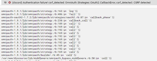

if its any consolation, I can repro, I believe, I’m getting the same error:
(discord) Authentication failure! csrf_detected: OmniAuth::Strategies::OAuth2::CallbackError, csrf_detected | CSRF detected

Nice digging! This kind of race condition could certainly cause the issues you’re seeing.
That said, we haven’t had any other reports of this problem, so it sounds like it must be something specific to your site/configuration. What plugins do you have installed on the site? Can you open up the “update” call and see what payload is being sent?

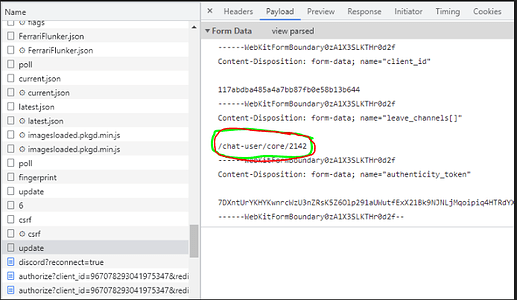

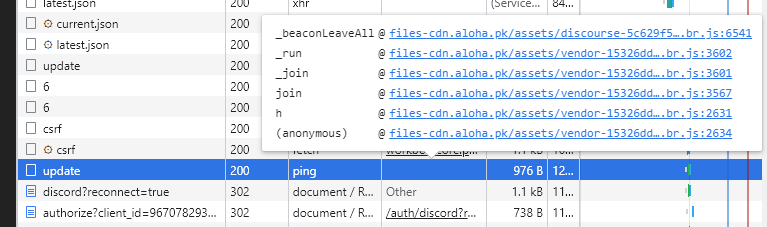

After taking a look at the update calls, I’m thinking you’re right. Here are some screenshots of confirmed ‘update’ requests that caused csrf failures.
csrf1
csrf2
I’m seeing a pattern involving cdn :face_with_monocle: What would be misconfigured with that? Let me know if you still need a list of our plugins, I just figured I’d save this reply from +1 picture :smile:
I have an exciting update! A few days ago, I took a closer look at the ‘update’ payload and happened to successfully associate this:
with one of our plugins! :partying_face: :expressionless: :smile:
After disabling the plugin, further testing, and a successful launch of the related feature to the community… I think I can confidently say we found the culprit.
