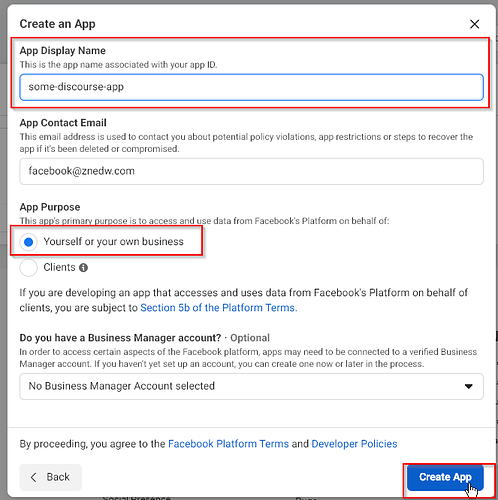

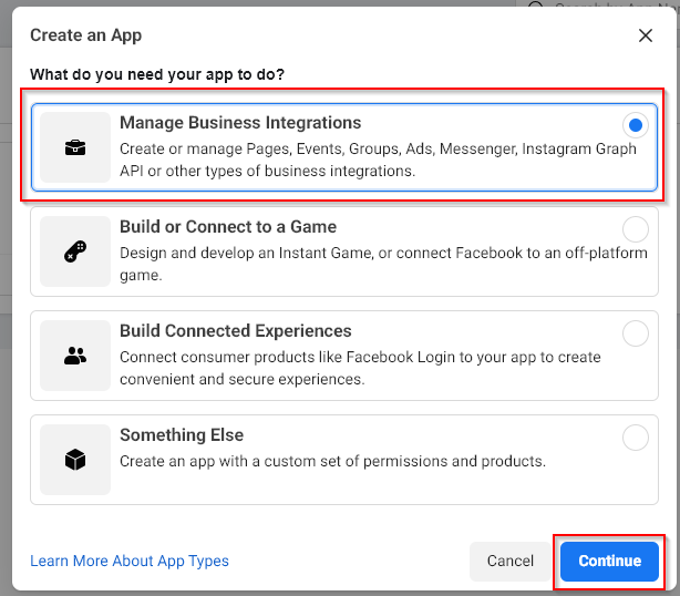

Step 1:
Step 2:
Step 3:
Step 4:

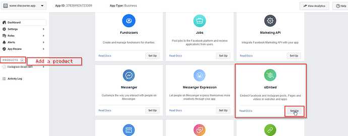

Step 5:
add oEmbed api
sign your life away
green tick for oEmbed

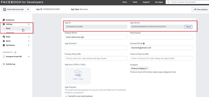

Step 6:
get creds from Settings > Basic
