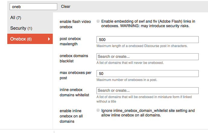

That sort of worked … the site is invite only.
From the site one boxes works for many other sites … just not locally.
It I past a link form production into staging I get the same result as above.
The settings seem ok.
