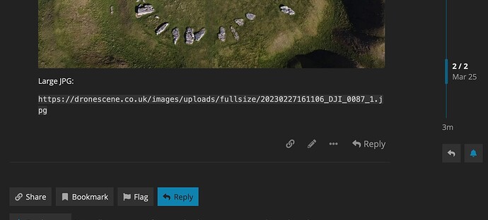

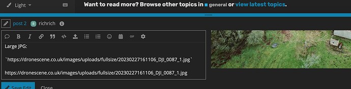

Large JPG:
https://dronescene.co.uk/images/uploads/fullsize/20230227161106_DJI_0087_1.jpg
Large PNG:
https://dronescene.co.uk/images/uploads/fullsize/20220103215207_IMG_5782.png

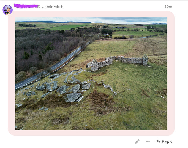

Hmm, it works here.
But it fails on try.discourse.org
Lorem Lorem ipsum dolor sit amet, consectetur adipiscing elit - #2 by richrich - general - Discourse Demo
See how the large one isn’t displaying?
Actually, I don’t think it does, the large image hasn’t appeared? :thinking:

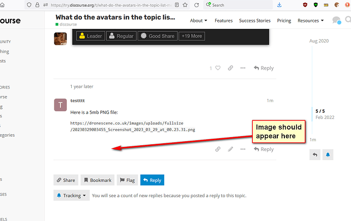

I first thought this bug might be due to the file size, our members often post 40MB+ images but I can replicate this issue on try.discourse.org using just a 5MB png image.
The image appears in the composer window when composing my post but does not appear in the post itself when submitted.
It also appears in the composer window if I then edit the post:
Here’s a onebox url image to try:
https://dronescene.co.uk/images/uploads/fullsize/20230329003455_Screenshot_2023_03_29_at_00.23.31.png
And to test it here on meta, it should appear here:
This bug is present on try and on meta.
The image did appear briefly when I submitted that post but then it disappeared again a few seconds later, I should have done a screen recording. Is it being lost/broken in the baking process? :thinking:

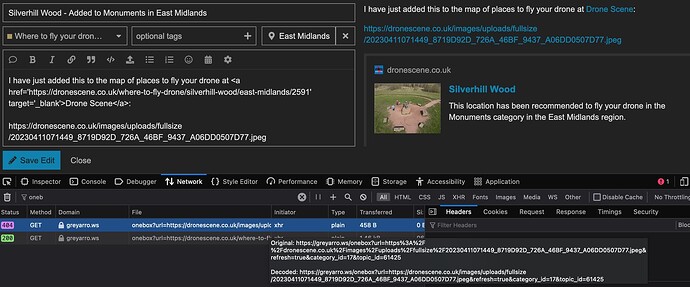

If I look at a post where the image has failed to be one boxed / pulled down a local copy, when I Edit the post I see this 404 Not Found error in the browser console:
The URL it’s trying to fetch is:
https://greyarro.ws/onebox?url=https%3A%2F%2Fdronescene.co.uk%2Fimages%2Fuploads%2Ffullsize%2F20230411071449_8719D92D_726A_46BF_9437_A06DD0507D77.jpeg&refresh=true&category_id=17&topic_id=61425
Unsure why it’s throwing a 404, when the image does exist :thinking:
https://dronescene.co.uk/images/uploads/fullsize/20230411071449_8719D92D_726A_46BF_9437_A06DD0507D77.jpeg
This has worked fine for the last five years, it’s only broken in the last three or four weeks.

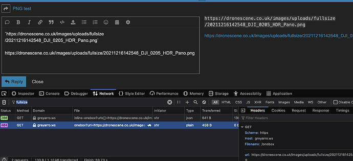

I’ve been having another run at it today, but I’m afraid I am no closer to working out what’s happening.
When I try and add the https://dronescene.co.uk/images/uploads/fullsize/20211216142548_DJI_0205_HDR_Pano.png it shows in the preview, and in the post for a second, and then is just blank. :person_shrugging:
I don’t see any 404s. I did think it was down to the size, as it was loading line by line in the preview like it was the 90s :slight_smile: But you said you tried with a smaller one and got the same. Which one was that, and I’ll try that one too. :+1:

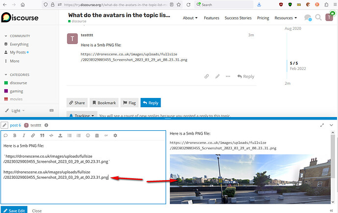

Here’s just a small 5mb image that has the same problem: https://dronescene.co.uk/images/uploads/fullsize/20230329003455_Screenshot_2023_03_29_at_00.23.31.png
And it should appear here:
Which as you say, it does for a second, then it vanishes again.
Yet it’s visible in the composer if I edit the post :thinking: :exploding_head:

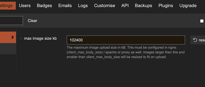

I believe it’s removed because the file is too large. By default, the max image size kb is 4096kb, and this specific file is > 5000 kb.
From my understanding, if you upload an image, it’s automatically resized/compressed before sending. You can upload large photos because of the client-side browser optimization.
With download remote images to local setting, Discourse will try to download the image as it is, and if it’s too large, it will be removed from post content.

Sorry @Arkshine I’ve looked in to this again this morning as I may have misunderstood your message earlier.
We changed our setting a number of years ago to allow images of up to 100MB in size.

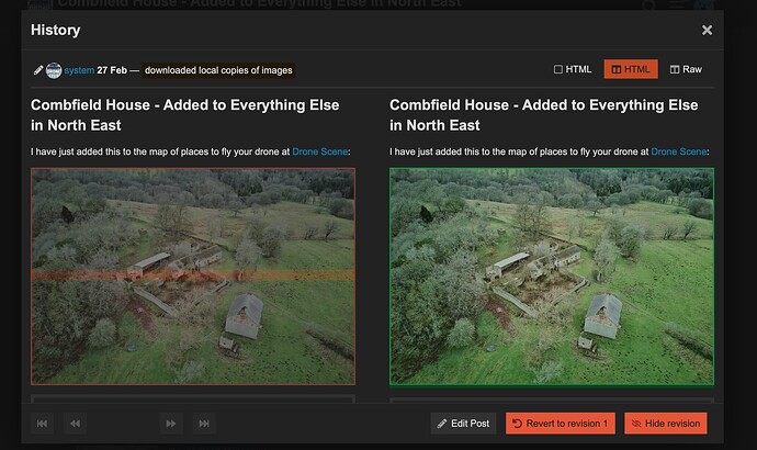

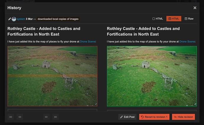

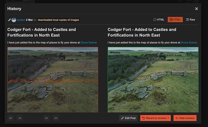

Here’s a 35MB image that was working on 3rd March 2023:
https://dronescene.co.uk/images/uploads/fullsize/20230303120013_DJI_0013.jpg
And a 27.3MB example from the same date in March:
https://dronescene.co.uk/images/uploads/fullsize/20230303120713_DJI_0055.jpg
And a 11mb example from 27th February:
I might have a wade through the commits made in the last six weeks or so and see if any of the commit messages jump out at me :slight_smile:
