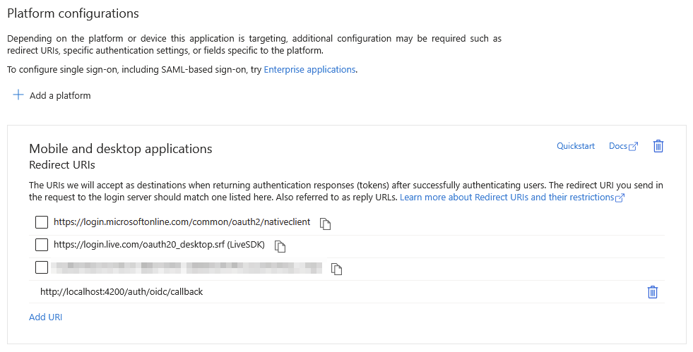

The redirect URI is configured in the Azure control panel as follows:
