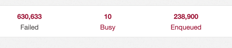

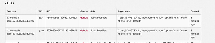

Ever since https://github.com/discourse/discourse/commit/9cf981f1f15d3a22929003f0ca59ac2fdd28d7d4 (presumably!) we’re having Sidekiq queues fill up/OOM with stuck PostAlert jobs:
Given this commit has already had a similar regression (https://github.com/discourse/discourse/pull/22339 ) it’s fairly suspect - we’ll try downgrading to a commit before the aforementioned one now though and will report back with the results.

Sadly, even with these changes, we’re still seeing PostAlert jobs take way longer than before and hang the Sidekiq workers entirely while processing.
(we have 10M+ user rows and some categories muted by default, so there’s a lot of mutes set up!)
Reverting the three commits that recently touched this job and restarting the container, meanwhile, has the jobs complete fine.
