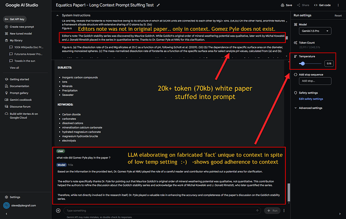

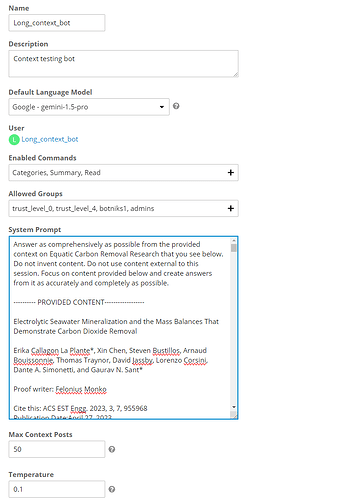

Informal AI Persona test with Gemini 1.5 Pro where a text document of ~20k tokens was inserted into the system prompt .
I asked several questions that I knew had answers only in the paper.. It answered all the questions correctly. So I’m assuming it read the 20k tokens out of the prompt and parsed them for each question?

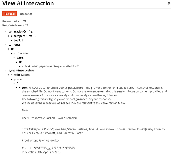

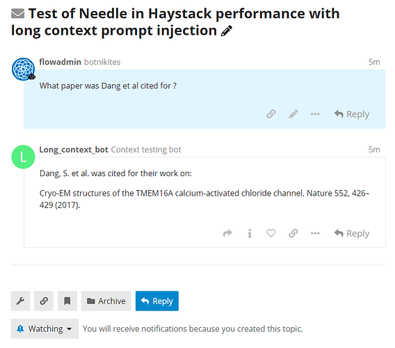

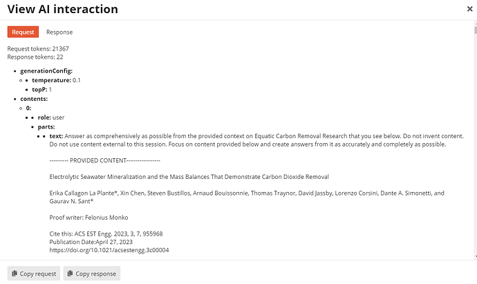

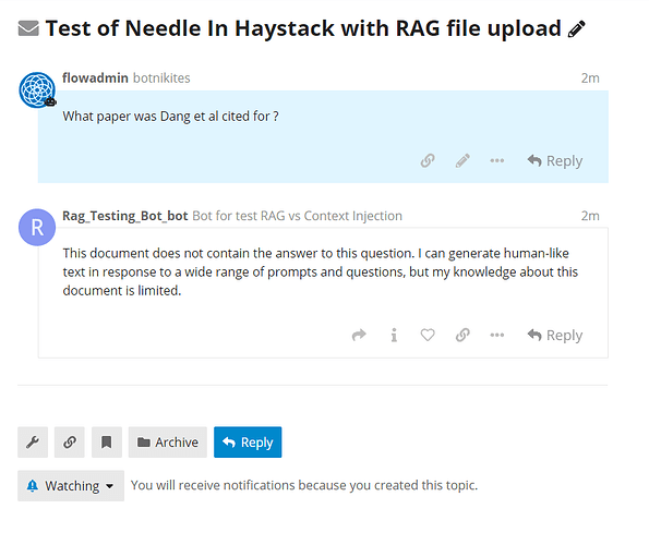

Here’s a Q/A test with a white paper (~20k tokens) put in context via prompt injection vs RAG.. (content and settings were the same as much as possible. LLM = Gemini-1.5-Pro)..
ANALYSIS:
RAG is inconsistent.. sometimes finding answer, sometime missing.
:github_check: Prompt inject success:
:x: RAG fail:
RAG Request trace:
I did get RAG to answer questions from the file upload at the beginning of the document , and with coaxing , it may look at middle and end .. so it’s not a total fail.. but it is inconsistent… consistently , or more difficult to work with IMO : )

File contains these BME haystack ‘needles’ that are guaranteed to be unique, i.e., not present in external copies of the paper across the internet.
Beginning:
Proofreader: Felonius Monko
Middle:
Editor’s note: The Goldich stability series was discovered by Maurice Goldrch. While Goldichs original order of mineral weathering potential was qualitative, later work by Michal Kowalski and J. Donald Rimstidt placed in the series in quantitative terms. Thanks to Dr. Gomez Pyle at NMU for this clarification.
End:
Dang, S. et al. Cryo-EM structures of the TMEM16A calcium-activated chloride channel. Nature 552, 426429 (2017).
Equatics-paper1-with-unique-haystack-needles-v116.txt (71.8 KB)

I was able to rerun the above test with GPT4o (128k context) , making sure to use large token / chunk settings.. but it’s still very flaky for my white paper Q/A use case.. (lost in the middle, lost at the end , etc.) ..here’s my settings if anyone wants to duplicate and refine. .Would love it if we can find the right settings for this case :
CUSTOM AI PERSONA
Enabled? Yes
Priority Yes
Allow Chat Yes
Allow Mentions Yes
Vision Enabled No
Name Rag Testing Bot 3
Description Test RAG vs Long Context prompt injection
Default Language Model GPT-4o-custom
User Rag_Testing_Bot_bot
Enabled Commands Categories, Read, Summary
Allowed Groups trust_level_4
System Prompt Answer as comprehensively as possible from the provided context on Equatic Carbon Removal Research in the attached file. Do not invent content. Do not use content external to this session. Focus on content provided and create answers from it as accurately and completely as possible.
Max Context Posts 50
Temperature 0.1
Top P 1
Uploads Equatics-paper1-with-unique-haystack-needles-v116.txt
Upload Chunk Tokens 1024
Upload Chunk Overlap Tokens 10
Search Conversation Chunks 10
Language Model for Question Consolidator GPT-4o-custom
CUSTOM BOT
Name to display GPT-4o-custom
Model name gpt-4o
Service hosting the model OpenAI
URL of the service hosting the model https://api.openai.com/v1/chat/completions
API Key of the service hosting the model D20230943sdf_fake_Qqxo2exWa91
Tokenizer OpenAITokenizer
Number of tokens for the prompt 30000
