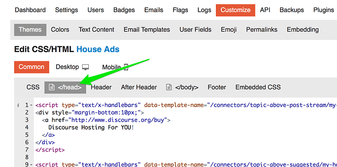

Eu pensei novamente sobre essa solicitação e, como se vê, é bastante simples de implementar sem um plugin agora, usando Componentes de Tema.
O código para colocar um anúncio acima dos tópicos e após cada 3 posts:

<script type="text/discourse-plugin" version="0.8.23">
    api.decorateWidget('post:after', helper => {
        let post = helper.getModel();
        if (post.get('post_number') % 3 === 0) { // após cada 3 posts
            return helper.rawHtml(`
<div style="margin-bottom:10px">
  <a href="http://www.discourse.org/buy">
    Hospedagem Discourse PARA VOCÊ!
  </a>
</div>
</script>
14 curtidas

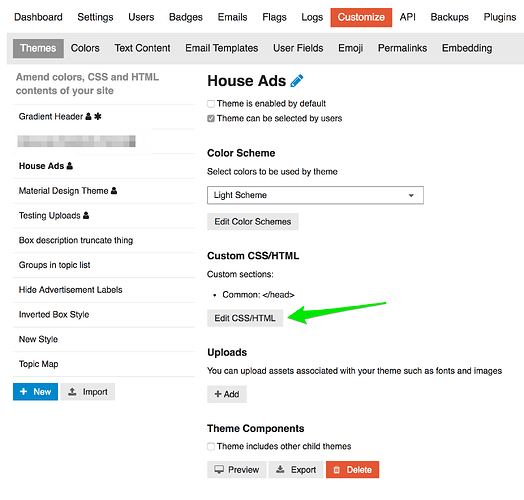

I copy/pasted the code into and it didn’t do anything. Any advice?
Did you enable the theme? Or preview it?
1 curtida
Thanks for the follow-up. I’m sorry for my late reply. I copy/pasted it into my current theme (with many theme components added) shown at www.sqrpgz.com, and I both previewed and enabled, but nothing. Then I created a new theme titled “house ads”, copy/pasted into the head, and enabled that theme – still didn’t work. Then, I went back to my original theme, and added the “house ads” component – still didn’t work. I may likely be doing something wrong here, and I appreciate any advice!

Try simply to change this line of the script:
to
4 curtidas
That worked. Thank you!
