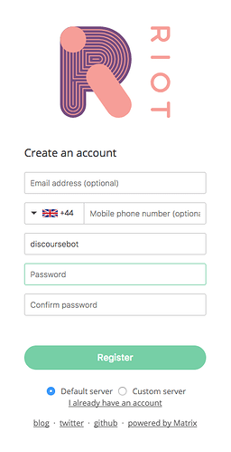

  2. Create a user account for your bot. You’ll probably want to write down the password somewhere in case you want to log back in later. Discourse does not need it.

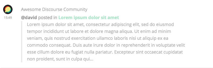

  9. Use the Test button on the channel you just created to check that everything’s working. You should see something like this:
