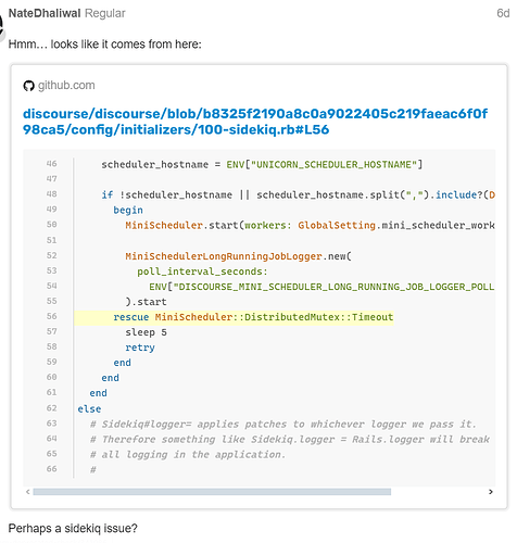

¿Es esto un problema de Sidekiq y, lo sea o no, se solucionará?
Job exception: MiniScheduler::DistributedMutex::Timeout
Nos 18:21
mini_scheduler-0.17.0/lib/mini_scheduler/distributed_mutex.rb:43:in `synchronize'
mini_scheduler-0.17.0/lib/mini_scheduler/distributed_mutex.rb:15:in `synchronize'
mini_scheduler-0.17.0/lib/mini_scheduler/manager.rb:365:in `lock'
mini_scheduler-0.17.0/lib/mini_scheduler/manager.rb:316:in `tick'
mini_scheduler-0.17.0/lib/mini_scheduler.rb:76:in `block (2 levels) in start'
Publicado por NateDhaliwal:
