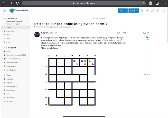

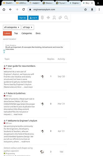

Hi,
I found that my site is not responsive on my tablet. But it is responsive if I disable the plugins in safe-mode. I have only official plugins on my website.

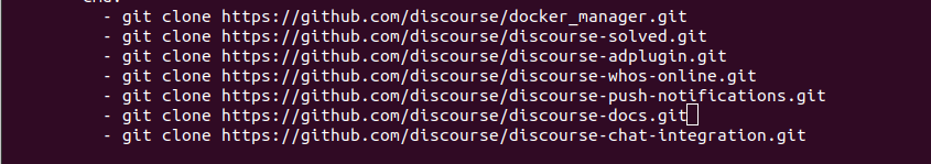

I have the following plugins on my website:
The issue is not visible on meta. I think it’s because meta is not using the discourse-adplugin.
Website as seen in the tablet:

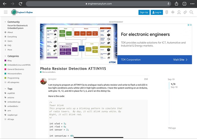

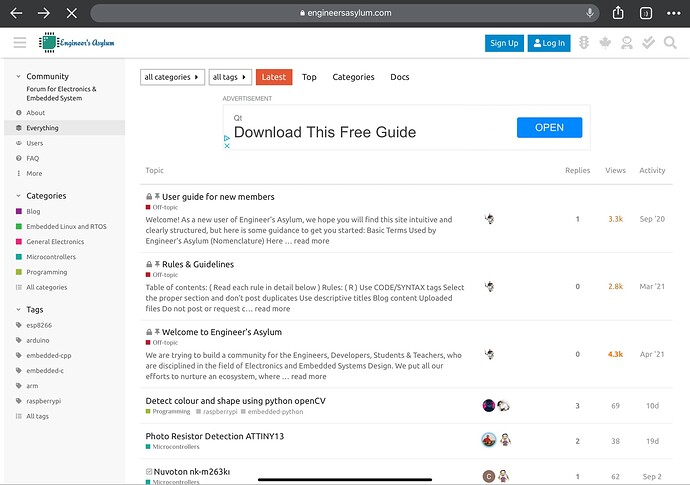

7

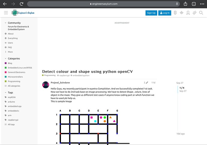

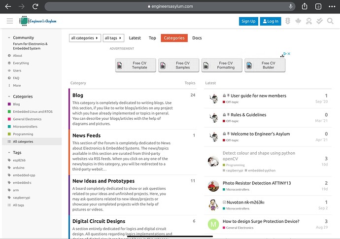

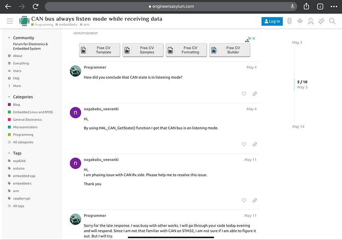

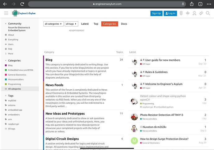

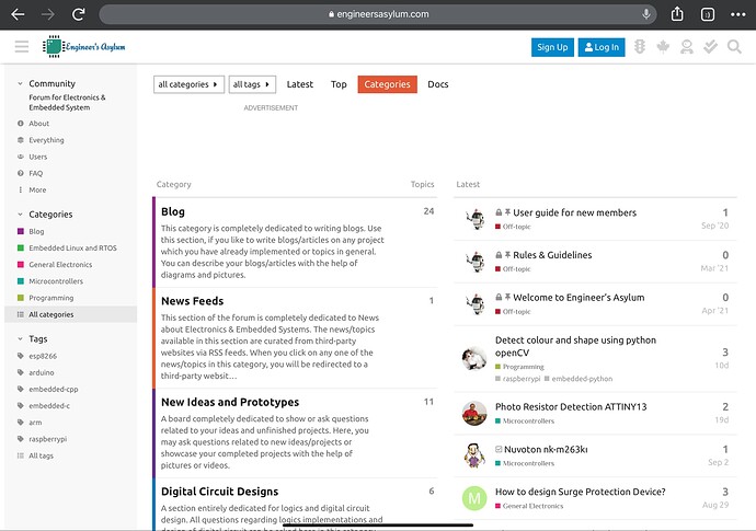

This is what I’m seeing on my iPad Pro FWIW.
Let me know if you’d like me to try again after you toggle any settings.
Adblockers active
Adblockers inactive

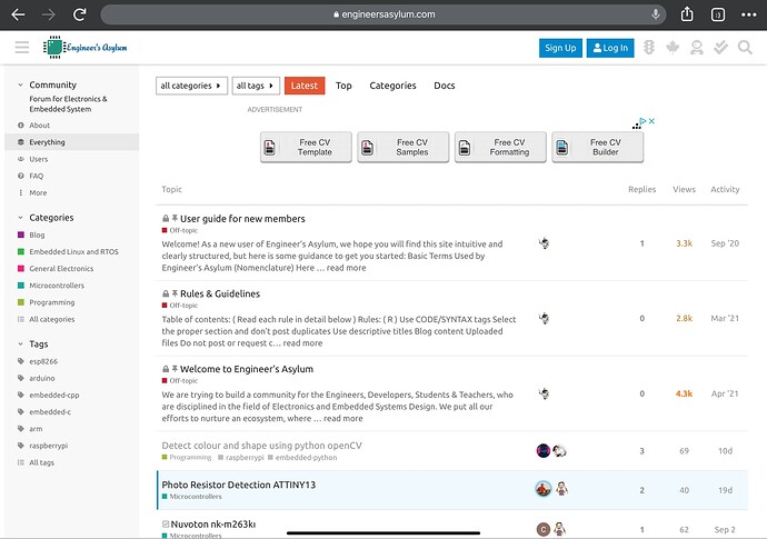

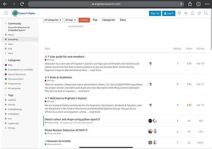

khenmu
(John Sweeney)

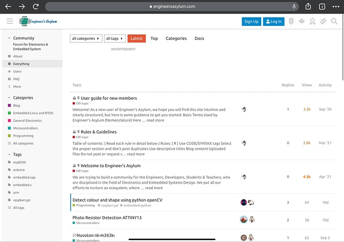

11
Not noticing any obvious differences, maybe due to caching?
Adblockers active
Adblockers inactive

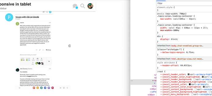

Hello, Oh yeah, I can repro it. It seems to the bottom .loading-container max-width under 790px cause this with open sidebar on topic pages.
Probably it should be good if adds to the core the --d-sidebar-width to this calculation when .has-sidebar-page available?
But I think you’ll have better experience on that screen size on mobile view.
