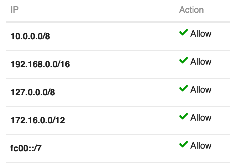

إليك قائمة عناوين IP المحجوبة؛ وبالإضافة إلى لقطة الشاشة أدناه، قمت أيضًا بإضافة عنوان IP للجهاز الذي يستدعي الـ API إلى القائمة البيضاء. (أستخدم مفتاح API على مستوى النظام لاستيراد مواضيع ورسائل قديمة من برنامج المنتدى القديم.)

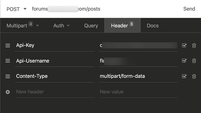

Can you post the code you are using to make an API request with credentials removed so that we can see how you are making the api request?
إعجابَين (2)

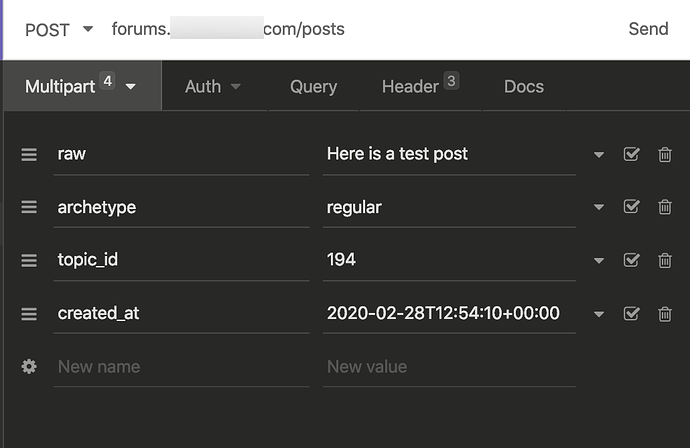

Hey @blake, thanks for the reply. Just to be completely sure it wasn’t a problem with my code, I put together the basic API call in Insomnia (similar to Postman but IMHO simpler/easier). Unfortunately, same results, but at least now it’s very clear:
Here’s the call I prepared to create a new post (I have already “minimum number of words in posts” turned down to 1):

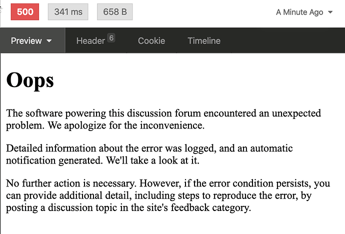

And here are the results
And the 2 error messages in the logs from these test calls:

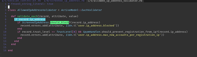

The interesting thing though is that this code is checking for the existence of an ip_address before making that sql request that is throwing the 500.
