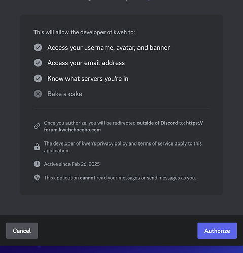

I’ve setup discord login on my self hosted installation. It works pretty great…except for one small thing.
When a user signs in with discord, they are taken to the authorization page every time, meaning they have to agree the authorization anytime they login. From my understanding, this should just be a one step process upon the very first time they connect discord login with discourse.
Anyway how to fix this? I followed the documentation.

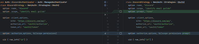

Looking through the file, I added
option :authorize_params, prompt: 'none'
underneath
option :authorize_options, %i[scope permissions]
on my self hosted install.
It sort of works…, but not as we’d like.
It still takes you to the discord auth page, however, the user no longer has to click authorize. The page will reload then take you back to your discourse page.

Edit: I see @Arkshine and I tested the change and got the same result.

Even with the change, it still proceeds you to the discord authentication page - which it shouldn’t do (although this time you don’t need to manually press authenticate).
