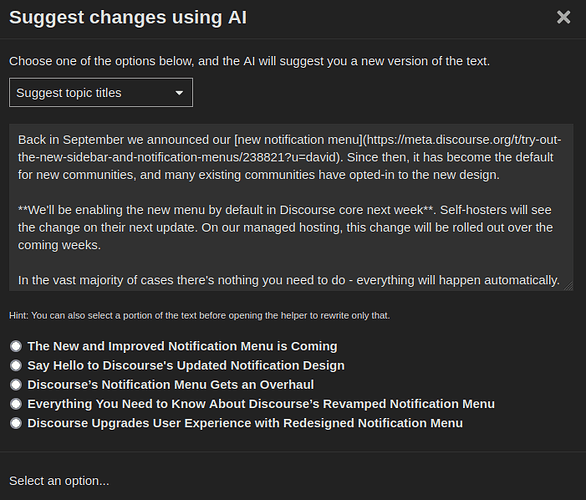

Feature set
The Composer AI Helper module adds a :sparkles: button to the composer toolbar, that when clicked let’s you choose between a list of AI-powered tasks to enhance your post.
At the moment it can:
  • Suggest topic titles
  • Proofread
  • Translate to English
  • Create markdown tables

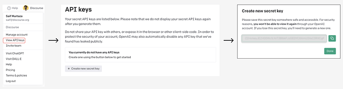

Generate the API keys
  1. Log in to Open AI. An API key can be obtained here https://platform.openai.com/account/api-keys
  2. Generate the API Key
  3. Once the key is generated, store it in a safe and secure place and copy it

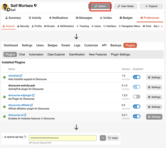

Using API key for Discourse AI
  1. Navigate to your Discourse profile
  2. Go to Admin settings and then Plugins
  3. Search or find Discourse AI and click settings
  4. Search or find ai_openai_api_key and input your copied-over key

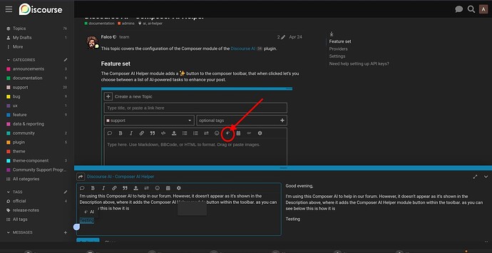

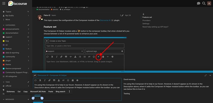

Good evening,
I’m using this Composer AI to help in our forum. However, it doesn’t appear as it’s shown in the Description above, where it adds the Composer AI Helper module button within the toolbar. as you can see below this is how it is
The issue is that the AI icon is behind the toolbar when I highlight the word, causing a problem when using a mobile device or a tablet.
when i hold down and swipe away i can see it

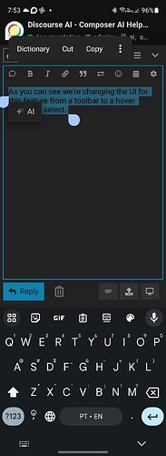

As you can see we’re changing the UI for this feature from a toolbar to a hover button on select.
It’s still underwork, but it should work on mobile already, at least it’s working on my phone
