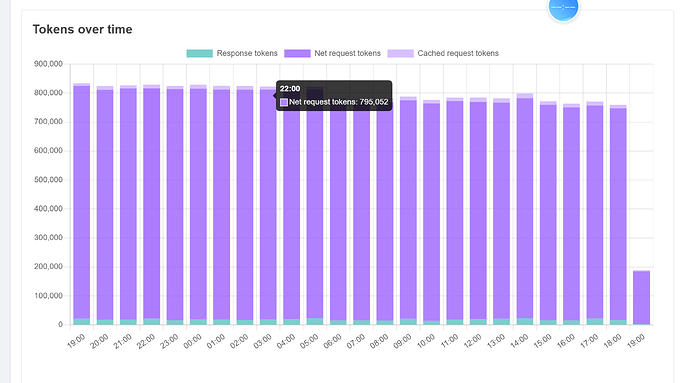

I followed the official tutorial to configure Discourse AI for translation and set it to translate all past posts over a span of days. Indeed, this resulted in a substantial amount of input and output tokens. However, after two days, I encountered a situation where only input tokens were being processed without any output. I am unsure of the cause—could it be that all the previous posts have already been translated? If so, what measures can I take to reduce token input and thereby conserve costs?

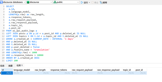

The usage graph definitely looks concerning. Can you try out this data explorer query:
SELECT
  a.id,
  a.language_model,
  LENGTH(p.raw) as raw_length,
  a.response_tokens,
  a.raw_request_payload,
  a.raw_response_payload,
  a.topic_id,
  a.post_id
FROM ai_api_audit_logs a
LEFT JOIN posts p ON p.id = a.post_id AND p.deleted_at IS NULL
LEFT JOIN topics t ON t.id = a.topic_id AND t.deleted_at IS NULL
WHERE a.created_at > CURRENT_DATE - INTERVAL '1 days'
AND p.user_deleted = false
AND a.feature_name = 'translation'
AND LENGTH(p.raw) < 1000
AND a.response_tokens > 10000
ORDER BY a.created_at DESC
LIMIT 100
The query should show you the number of response tokens used based on the post’s raw length. Ideally you should see a similar number, not more than 1.5x tokens. The AiApiAuditLog will help with determining what is going on.

I am not sure how the OpenAI API deals with getting hit about 3000x per hour. Basically for your setup, per post we are doing :one: locale detection, :two: translate to Japanese, :three: translate to English. If you check /logs I suspect you’ll see your site hitting rate limits.
I suggest lowering it still to 50 and see how it goes.
We’ll be implementing a way to view translation progress of the entire site as well in the near future.

Furthermore, when I execute the query command you provided, the database returns no results. Is there perhaps a need for some customization or modification?
Hmm this query should work. Do you have the discourse-data-explorer plugin?
