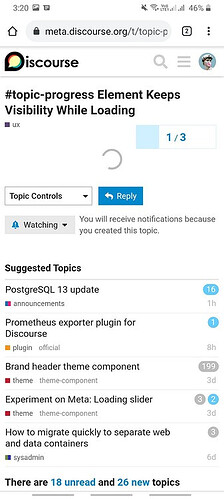

The #topic-progress element appears in an anti-pattern fashion while the spinner is visible.
You can regenerate the behavior, just open a topic and click on the title link on top using mobile view to provoke the spinner.
Any ideas how to hide the #topic-progress while the spinner is visible?

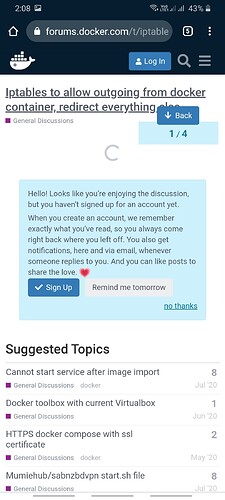

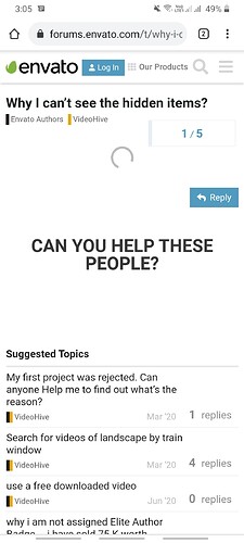

Surprisingly the meta is exempted from this flaw, but I was able to reproduce it in our production servers and almost all other sites I know.
Another example:

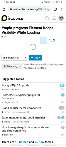

Edit: it appears that when a topic has many posts, the (topic progress) element will not be visible without scrolling. That’s why I couldn’t reproduce it in some sites before like meta.
